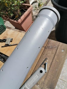

Step 1: Drilling the Pipe

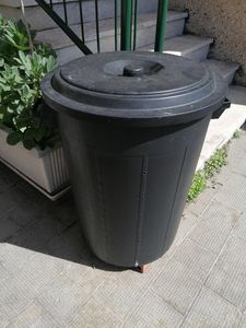

After reading the Instructable "Easy Home Compost Bin" (by jsrubianoch) and the good ideas expressed in that tutorial, I tried to create my own home composter, trying to improve something.

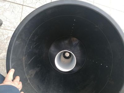

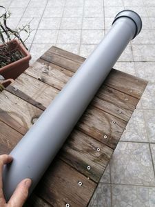

I bought a bin similar to that one proposed (the store was selling only a black type) that is 100 litres, and a piece of PVC grey soil pipe one meter long and 90 mm in diameter. The first thing I noted is that in the original project the pipe was free to move. Since the material put in the composter must be mixed frequently, I thought of a way to fix the pipe to the bottom of the bin.

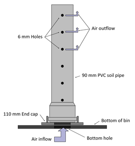

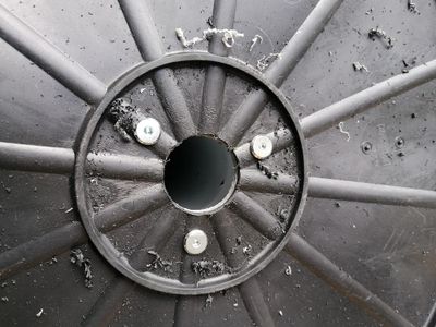

The pipe is flanged and the flange has an external diameter of 110 mm, which fits perfectly in an end cap of that size. I bought the 110 mm PVC end cap, and I fixed it on the bottom of the bin with three small bolts. (In any case an end cap with 90 mm in diameter could work).
After I cut the pipe to the correct length, divided the circumference into four, drawing a longitudinal line for each division and drilled a series of holes 80 mm away from each other, with a 6 mm tip.
Step 2: Drilling the Bin
Before placing the pipe inside, I drilled with a hole saw the bottom of the bin and the PVC cap for airflow. Without the presence of oxygen the system will be anaerobic and it will start to ferment and smell.

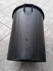

Finally, I also drilled the bin following the same procedure as the pipe, but with a 10 mm tip, only on four rows. If it will be necessary (and I will understand it from how the compost process will evolve), I can increase the number of these aeration holes. Just to remove any liquid that could form on the bottom of the composter bin during the fermentation process (leachate) I also drilled, threaded and screwed a 6 mm bolt, to be able to unscrew and drain the liquid in an easy way.
This liquid, properly diluted, can also be used as fertilizer. Make sure to clean all the holes properly to avoid plastic shavings in the compost. Remember that the bottom of the bin must be raised above the ground using, for example, just two bricks, leaving the central hole free for air inflow. For my wife delight, since the decaying material is not easily accessible from the outside, it will be difficult for some mouse to enter and hide inside.

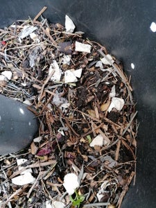

Step 4: How to Make Compost
Making compost is not just throwing ingredients into a bin and waiting for them to turn into humus. You have to take care of the ratio between greens and browns, aerate the compost and maintain the air flow, check that the microorganisms and enzymes are working properly and finally verify the degree of humidity.
Process accelerators are additives that will speed up the process of introducing microbes to your compost, so it can start maturing right away. You can also just buy accelerators from your local gardening store if you want a fool-proof way to activate your compost, or you can just use some beer, that doesn't have to be a good one. Another important component is stale bread, which can act as a booster for the development of compost, but if in excess it becomes counterproductive because it releases acetic acid and ethyl alcohol (in the picture you can see pieces of "piadina romagnola")
Things like too many greens (nitrogenous material), too little aeration, too much moisture, and not being mixed well can cause a bad smell of a compost pile. Check your compost every now and then. If it smells badly, try turning it over to ventilate the mix.
Bacteria, or microorganisms, and enzymes help in breaking down organic material. Adding earthworms to the decomposition process, a practice known as vermicomposting, will help.
All of these ingredients mix to form an optimal blend that breaks down into a final product similar to humus, which is the dark, organic matter found in soil as elements decay.
