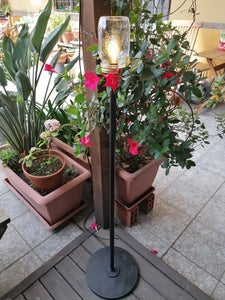

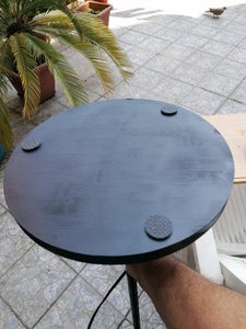

The biggest difference with that project is that I can't insert any part of the lamp support pole into the ground, just because I don't have any ground. This is why I looked for a 1/2" diameter conduit, only one meter long and threaded at both ends, also thinking about a suitable base, perhaps made of wood, on which to fix it.
I found a 28 cm diameter round bamboo cutting board as a support base, where, with four screws, I fixed the 1/2" floor flange. Pay attention that the thickness of the base must be at least 1.5 cm to have a really solid support. Mine was 1.7 cm thick.
Then I screwed one conduit pipe end into the floor flange. Three rubber feet under the bamboo base to increase stability (three are better than four on not perfectly flat surfaces) and that's it: I had a stable terrace pole for my lamp.

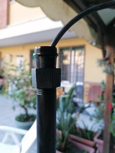

I made a hole in the conduit tube at 25 cm from the bottom end and passed the electric wire internally.

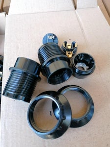

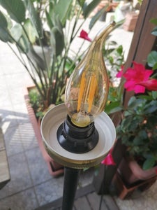

I bought also a 1/2” threaded cast iron female cap for closing the conduit tube top end. Making a 10 mm hole on top of it I was able to insert a metric M10x1 threaded tube, the one used when restoring lamps, 20 mm long with its related nut, where I could screw my new E14 lamp socket. I preferred this way instead of fixing that nut to the conduit tube with epoxy adhesive (it's a good idea anyway).

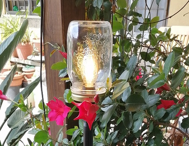

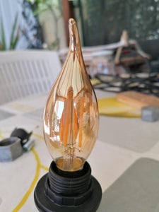

Then I connected the lamp holder I bought with a threaded lamp holder rings. I used an E14 amber LED bulb in the shape of a candle flame with 4W vintage filament and a very warm 2700K light. This is a really beautiful light bulb and its light is really warm and soft.
Step 3: Fitting the Mason Jar

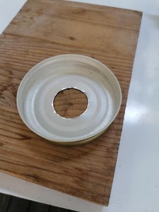

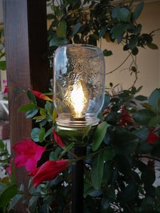

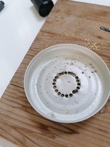

I then bought a Mason jar with a high screw lid and with embossed decorations and then drilled a hole the outside diameter of the bulb holder in its lid. I then placed this lid between the retaining ring and the bulb holder ring. Just as I was trying to screw the jar upside down on the lid, my wife suggested covering the outer surface of the jar with lace. This would have avoided seeing the bulb's filament, improving the spread of its light.
Can you picture me drinking wine or beer with my friends, rough, almost savage men, surrounded by fluttering white lace ... So I told her it would be too frivolous and, oddly enough, she agreed. Certainly this last modification would not have allowed the terrace lamps to be left outdoors. In case of rain the water would have completely unglued the lace, ruining everything.
But it was still a good idea.
Step 4: What an Atmosphere!
Another piece of advice my wife gave me was to paint all parts of the lamp frame a nice matte black. And this time I did, or rather, I obeyed. I can't contradict my wife twice in a row.
I repeated the various steps to get three lamps (four lamps would create a morgue atmosphere only good for Halloween) and when they were completed I just had to call my friends and look for a good bottle of red wine in the cellar.
