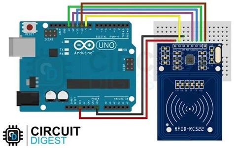

Step 1: The Configuration
The RC522 RFID module has 8 pins and supports multiple communication protocols like SPI, I2C, and UART. For Arduino projects, SPI is the most commonly used protocol.
Let’s connect the module by following these steps.
1 — Power Connections
Connect the VCC pin (supply voltage between 2.5V to 3.3V) to the Arduino’s 3.3V pin. Then, connect the GND pin to the Arduino’s GND.
2 — SPI communication pins
  1. Connect SDA (also called SS) to Arduino’s pin 10 (Slave Select).
  2. Connect SCK (Clock) to pin 13.
  3. Connect MOSI (Master Out Slave In) to pin 11.
  4. Connect MISO (Master In Slave Out) to pin 12.
3 — Control pins
  1. Connect RST (Reset pin) to Arduino’s pin 9.
  2. The IRQ pin (interrupt signal to indicate RFID tag detection) is optional and can be left unconnected.
Note: Use the 3.3V pin to power the RC522, not 5V. The IRQ pin is optional and can be left unconnected.

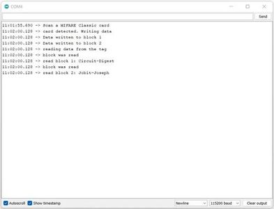

Step 3: Writing Data to the RFID Tag
Now that we have dumped the factory data from the tag, let’s see how we can write some data to it. Use the following Arduino code to write and then read back data on the RFID tag.

How does it work?
  1. The program initializes the SPI bus and RFID reader, sets up a default key (0xFF x6) for authentication.
  2. The loop() waits for a new RFID card. When detected, it writes two data arrays to block 1 and block 2 of the tag.
  3. After writing, it reads the same blocks and prints the data to the serial monitor.
  4. The writeBlock() function checks if the block is writable (not a trailer block), authenticates, and writes data.
  5. The readBlock() function authenticates and reads data from the specified block.
Once uploaded, open the Serial Monitor at 115200 baud, scan your RFID tag, and watch the data written and read-back data printed on the screen.
