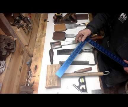

Once you've laid out the adjacent face to the arris off of the reference face you need to layout the adjacent face to the reference face opposite the arris. What a mouthful, hopefully after the first video the faces are clear to you.
As stated in the video above you should not have much need of a tape measure for this part of the layout. Your framing square should just about take care of the whole shooting match. Remember to square everything off of the reference face for this layout.
Using the reference face for all measurements and layouts is what you need to do to make up for any imperfections in the timber itself. You are trying to find the inner square of the timber so to speak. Once this is all done you are ready to start cutting the joint.
