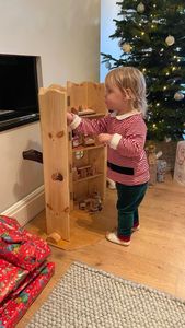

Step 8: Summary
My granddaughter (and daughter) were very pleased with it on Christmas morning.
She has now added a fairy family to the tree stump house, which I think is quite fitting.
I did consider fitting a roof and chimney above the top floor, similar to another floor but sloping, but didn't have time but I don't think it is missed.
Also there are no stairs, but again no one has complained...
