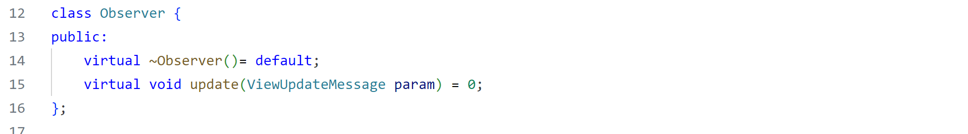

In order to achieve this, there is a basic observer class. An observer subscribes to a subject, by registering.
The observer is implemented as an abstract class. The update method needs to be implemented in a concrete class. This will be later the view of the game.

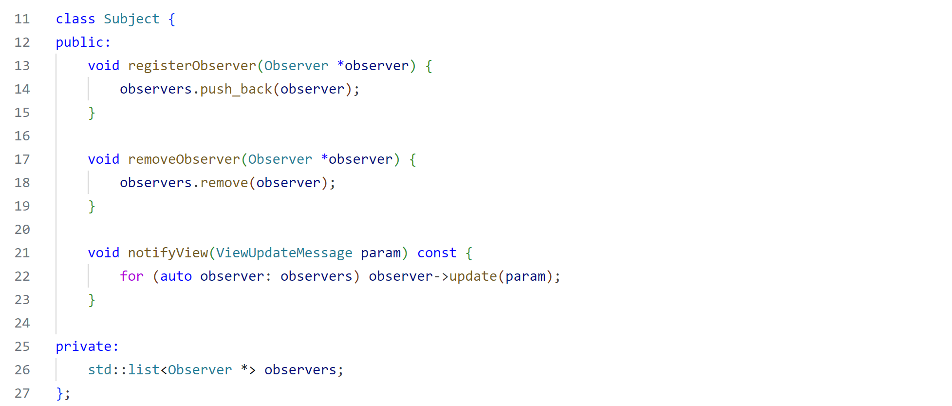

In addition to this there is a subject class that notifies all registered observers (line 21-23) about changes to the subject. The observer only need to call the registerObserver method. When registering an observer, it is added to a list. Each observer of this list receives updates.

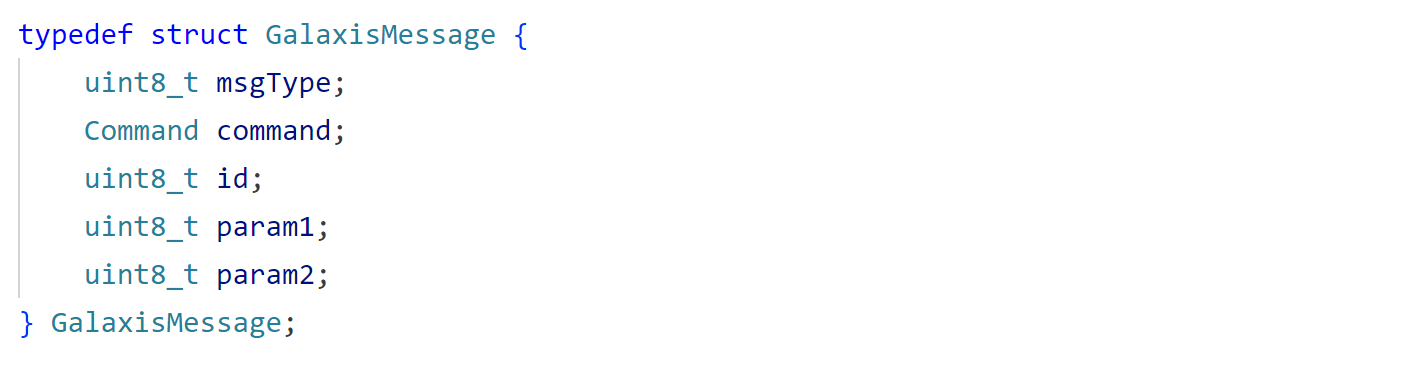

For the BLE connection, the same observer/subject logic is used. The type GalaxisMessage is designed to exchange messages over BLE:
This GalaxisMessage holds the type of the message (e.g. a request or a response), the comand (e.g search, next_player) and the id of the receiver. In case of a broadcast message to all connected clients, the id takes the value of 0xFF (255). Some additional numbers (e.g. the current searchResult) can be added to the param1 and param2 fields.

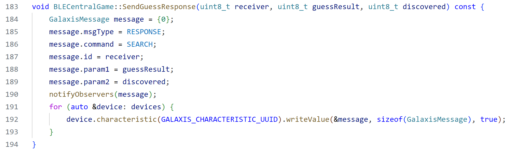

Here is an example how a search request from a BLE device (client) gets answered by the BLE central (server):
Line 184 creates a new empty GalaxisMessage. From line 185 to 189 the new message is composed, and in line 190 the observers are updated.
In addition to this all connected clients will receive the GalaxisMessage as well, to update their model and view.
