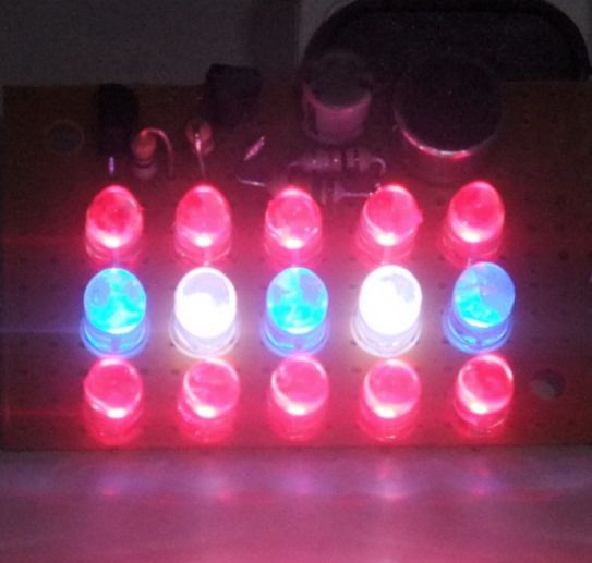

The last image shows the easiest connect to make: a 100-ohm resistor joined to a (common-anode) RGB 5mm LED whose legs had been spread to fit. A translucent sphere (courtesy of the last Beer-Pong competition) acts as an integrator to show almost endlessly changing color.

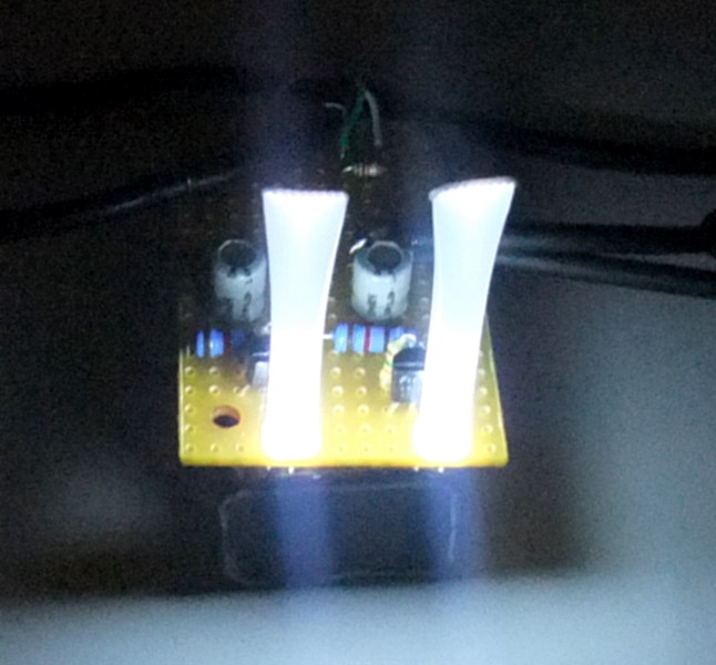

I've used Copper-clad boards to ease construction and the photos below show fairly simple layout. The only critical area is the 6-pin header interface. The last photo is the 'X-Ray' view to show component and wiring layout.
