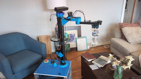

Introduction: A Useful Autonomous Home Robot, the UR3
I designed and built a useful home robot to navigate around the house and help with simple tasks.

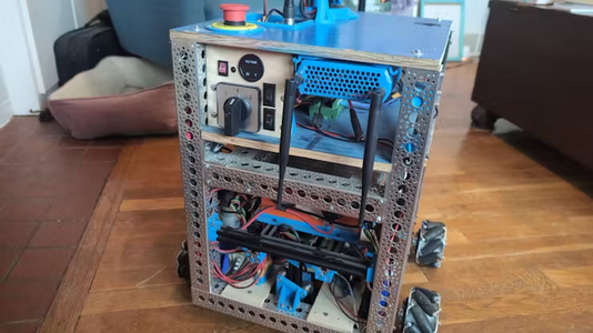

Step 2: The Robot Base
The base of the robot contains the drive base and the computing hardware. The drive base is pretty simple--some old dc motors drive Mecanum wheels through some 3D printed bevel gears. Everything on the base is controlled by a Teensy 4.1 microcontroller. This handles running the motors at the right speed to move the robot where it wants to go.

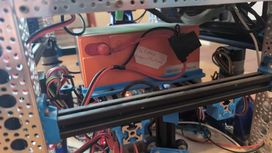

Step 4: The Battery
Additionally, a new feature of this robot is that it has a LifePo4 battery to run the robot fully untethered.
Step 5: The Brain
On the backside of the robot you can see the Nvidia Jetson Nano (In blue) which is the main computer running navigation. This talks to the other components of the robot like the lidar and drive base and figures out how to move from one part of the house to the other.
On the left is the power control panel, where you can turn on the robot, control power to individual sections, or charge.

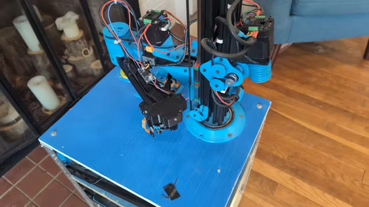

Step 6: The Tower and Arm
After I got the base robot driving around the house and navigating well, I started working on the tower/arm. This is a motorized "scara" type setup. I designed a 3D printed worm gear setup for the vertical axis which I enjoy watching.
The stepper motors are all controlled with CAN bus motor controllers making wiring super easy.

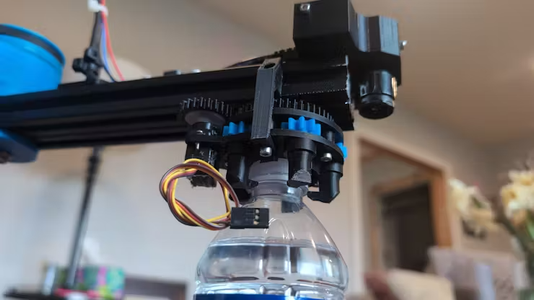

Step 7: The Bottle Gripper
(This isnt all wired up yet) The first task I want the robot to do is pickup and deliver water to family or guests. I decided to start with plastic water bottles so that I don't accidentally spill water all over my big project. Eventually I would like to add more attachments to the arm for more functionality.

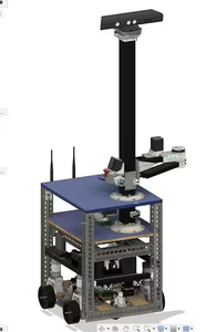

Step 8: CAD
Everything for the robot was designed in Autodesks Fusion360. Up until last year I was still a student, so I was able to make use of the student license, allowing access to tools like simulations which let me test the durability and strength of the arm.
