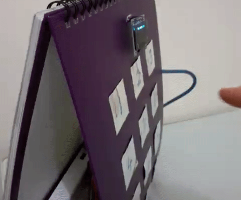

Step 1: Demonstration
When the door is open and the alarm is on, the microcontroller will take a few seconds to send a Telegram message before triggering the buzzer (alternatively, you can change the order). The buzzer cannot be turned off by closing the door - user can only deactivate it by RF remote control or Telegram message.
