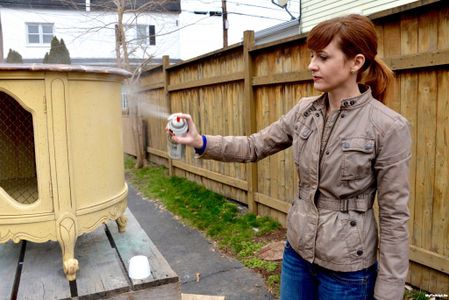

Step 2: Add Some Paint!
Before applying the colors I chose for the side table, I primed the entire table with Krylon CoverMaxx.
I chose Krylon’s Piston grey for the sides of the side table.

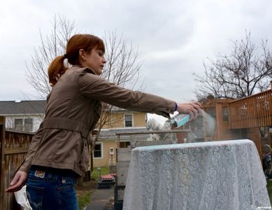

For the top, I used a lace technique. First, I applied Ballet Slipper pink to the entire surface. After it dried, I covered the top with lace and then painted Ocean Breeze blue.
For a little extra fun, I chose Watermelon pink for the inside of the cabinet.
Since it’s a table, I used a clear coat to seal the lace pattern on top.
