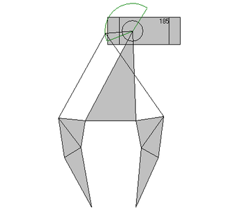

Step 6: Designing Poly-Joints
There are lots of ways of arranging the servos and joints to make a leg. Small changes in the lengths of the segments can make a big difference to how the leg moves.
This device is called a "linkage mechanism". There are several linkage-design web pages and my own Windows program is available on GitHub. Or google "free online linkage simulator".
My own program is designed to facilitate making legs. You can specify the "ground" plane and the height that you want to foot to rise to. You can then tell the program to optimise the lengths of the links to find the longest step size within that constraint. Having designed a linkage, you can ask what torque the servos will experience when supporting the weight of the body. You can specify a maximum torque and find the longest step size that doesn't exceed that torque.
For instance, in the design above, the maximum torque is 0.5kg.cm.
Having found a design I like, I then print it on paper and use it as a reference when making each leg.
The linkage mechanism is designed as a chain of triangles. In Edit mode, to create a new strut:
- Left-click on an existing point
- drag the line
- mouse button up then down to create a new point and strut
- move the mouse near another point
- Left-click to connect the second new strut
The program calculates the positions of points by considering the triangles in the order you created them. The last point to be created is always the "foot".
You can drag existing points by holding down the Shift key.
This program simulates linkage mechanisms and two servos or motors.
The sliders on the right adjust the lengths of the struts and the zero-angle of the servos. If you set a strut length to an "impossible" value then the drawing goes "elasticated".
In Optimise mode, it is assumed that you are trying to create a leg for a walking robot. You can adjust the position of the ground and the height of the step. The green box is the region that the foot must step over.
The optimiser tries to maximise the length of the step by making small changes to the lengths of the links. Always turn off the optimiser and let the program return to the "best" leg arrangement before saving the file.
In the Move mode, you can create servo-position "waypoints". Use the scrollbars at the right to move the servos then Right-click to get a popup-menu which allows you to save that position as a waypoint. When you "Run" the waypoints, the program linearly interpolates between the servo angles. That may not move the foot in a straight line and you may have to add more waypoints. Hold the Control key down to drag the foot.
In Torque mode, the program calculates the torque on the servos for a unit force upwards or sideways on the foot. It displays the maximum torque for the two servos as a coloured chart. The colours show the torque generated by either a horizontal or a vertical force (choose in Options). Darker colours mean the robot is weaker. If you move the mouse over a point, the torques due to the horizontal and vertical forces are shown at the bottom left. The torque generated in a real robot depends on the scale of the drawing and the weight of the robot. The torque is calculated and displayed in Newton-pixels and kg.cm.

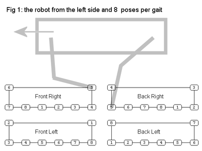

Let's define some terms. A "Pose" is a set of angles of the leg servos. A "Gait" is a sequence of "Poses" that makes the robot move - preferably without falling over.
How can we easily program an Arduino to do that? We'll store the poses of a gait in memory as a table of numbers - the servo angles - and play them back in sequence using a timer of some sort. Where do the numbers come from? We'll teach them to the robot by sending them from a PC.
Imagine you're making a stop-motion animation of a walking quadruped. You adjust the leg positions and take a photo. Then you adjust the leg positions again and take another photo. Eventually you've got a movie.
Servo18.exe is a Windows program that allows you to nudge the servo angles by sending commands to the INO sketch (see next section). You can then store their angles on the PC as a "Pose". The sequence of poses - the "gait-table" - can then be sent to the Arduino to be stored in EEPROM or can be exported as a *.H file.
A typical crawl walking gait might have 12 poses. When it's executing the gait, the Arduino will play-back the poses perhaps over 4 seconds.
That's 3 poses per second. To make it less jerky, the Arduino does "inbetweening". The gait-table provides the "keyframes".
Inbetweening is done by linearly interpolating the servo angles. Does that give a linear interpolation of the foot position? Not exactly but it's close enough if the change in servo angle is small.

Of course, you will have plugged the leg and gripper servos into different pins. You will have specified that in the Servo18.exe program.
Opening and closing the gripper is not really a "gait" but it's controlled by a gait-table so we'll call it a gait.

Step 10: The Crawl Gait
There are lots a web pages about the crawl gait for a quadruped so I'm not going to describe it in detail.
To walk forward, you lift one foot at a time and move it forward while the other three feet are forming a triangle. The centre of gravity of the robot is always inside the triangle. The order in which you lift the legs determines how big the triangle is. The optimum order of foot lifts turns out to be
- back-left
- front left
- back-right
- front right
The robot should, for instance, put the back-left foot down just before it raises its front-left foot. So, for a moment, all four feet are on the ground.
Why does a crawl gait require 12 poses?
For each leg we need poses for
- foot up at rear of stride
- foot up at front of stride
- N poses as the foot is down and moving backwards
There are 4 legs so that's at least 2*4=8 poses per gait - i.e. N=6.
But if you look at Fig1 you'll see that in pose 8, the back-left foot is going up while the front-left foot is going down. So we need to insert an extra pose in which both feet are down. Similarly for pose 4 and the back-right foot and similarly for poses 2 and 6. That's 4 extra poses giving 12 poses in total which gives Fig2. In Fig2 you'll see that in poses 1,4,7 and 10, all four feet are on the ground.
