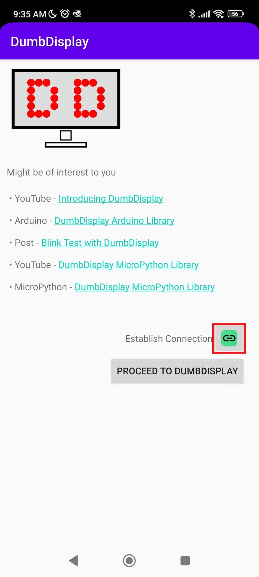

Step 5: Showing of IP and Connecting DumbDisplay Android App
With BUTTON or TOUCH SCREEN, you can trigger AWeatherClock to show the IP of your MCU to connect to with Android DumbDisplay app
Be the "trigger" mechanism BUTTON or TOUCH SCREEN, you "double click" to trigger showing of IP.
You will need this IP to make connection between AWeatherClock and your Android phone's Arduino DumbDisplay app for the remote UI, as will be described in more details next.
BTW. You might see that DumbDisplay Android app requires "LOCATION" permission to make use of your phone's GPS service. You can grant the permission with the Settings menu option of DumbDisplay Android app.
