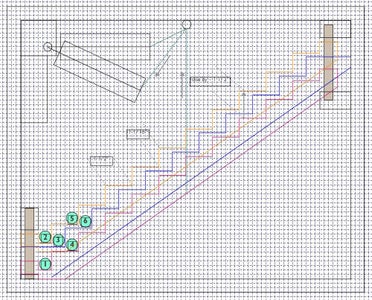

The marble run is built into a frame of size 16"(h) x 20"(w) with a depth of 3". The marble lift is made of two stair-shaped pieces. A static piece (the blue one in the sketch) and a moving piece which slides up and down on two wooden dowels (red indicates its lower position and orange its upper position), operated by a servo. The stairs of both pieces are slightly tilted to the right. Furthermore the stairs of the static piece (which is sitting in the back) are tilted toward the front, and the stairs of the moving piece (which is sitting in the front) are tilted towards the back.
When the moving piece is lowered, the next marble enters (1). When the moving piece is raised (2), the marble rolls backwards onto the solid piece and then to the right (3). When moving piece is lowered again, the marble rolls onto it, and then to the right (4). Then, everything repeats. So, in every cycle in which the front piece is lowered and then raised, all marbles walk up one step.
I did not plan the whole project in advance. I just started with the frame and the above plans for the marble lift, and improvised each further step. That's why I do not have a perfect drawing with the final measures. While each square in the sketch corresponds to 1/4", please note that these are only approximate sizes.
