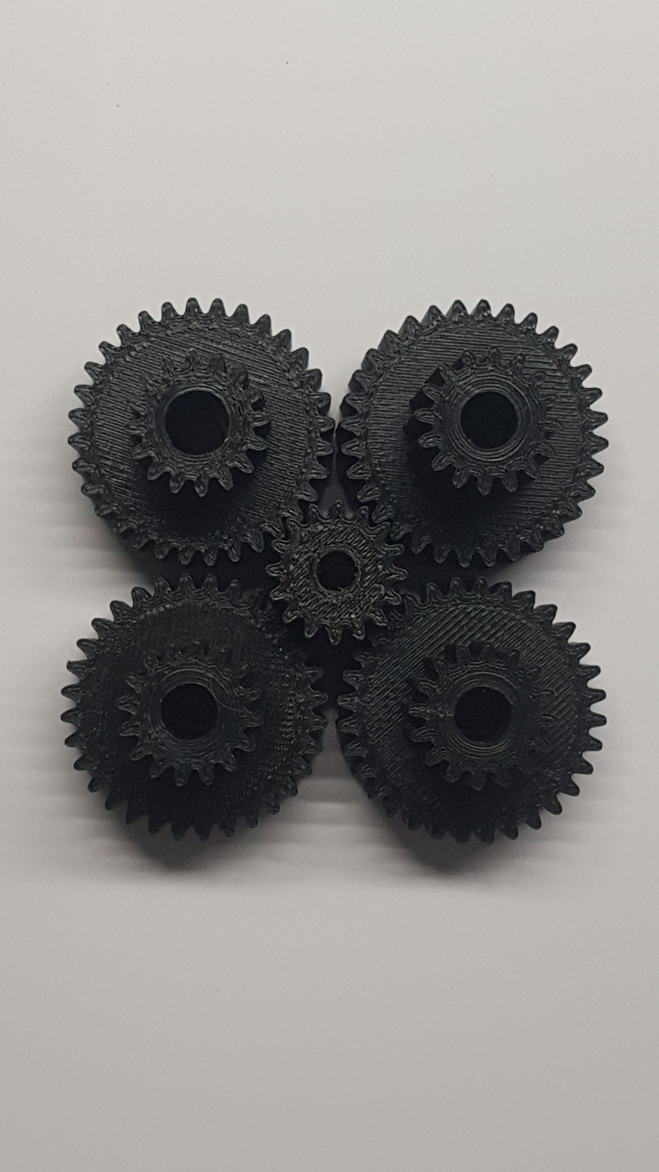

Coming to the transmission part, I used 2 x 1:2 spur gears that were designed by me, thanks to Autodesk's Fusion 360's Inbuilt gear maker tool. I used a layer height of 0.12mm with a 30% tri-hexagonal infill in order to maximise the layer adhesion and durability of the parts. After printing them, I added the 1/2 inch OD, 5 mm ID bearings to each of the gears both arranged in a sequential manner. The gear ratio of the motor to the wheels is approximately 3.45:1 reducing speed but increasing torque.
The gear ratio is the number of revolutions done by the engine to the number of revolutions done by the wheel. Basically, we compare the RPM of the Input side and the Output side. A higher Input side would mean slower output but more torque and vice versa.
In real life cars, gears are important because cars use Internal Combustion Engines. When starting from rest, if the engine is directly connected to the wheels (1:1 ratio) then the engine would just stop/turn off (stall) . This is because the engine faces a lot of inertia by the car's weight that stops it completely. In order to prevent this, we use gears. At a start from rest situation, we only need more torque and not speed. Hence, the output's RPM is lower than the engine's RPM. This ensures that the engine faces the least inertia. As we accelerate further, torque isn't required since the car's kinetic energy can keep it in motion. Hence, we increase the gear to for example the second gear where the engine's RPM is lower than when in the first gear to maintain the same speed.
Electric vehicles however, use obviously, electric motors in order to move the vehicle. Electric motors are very well capable in starting from rest situations that they do not necessarily need a transmission. This means that the car's acceleration would be noticeably smoother due to the absence of changing the gears. Plus, electric motors can achieve way higher RPMs than traditional Internal Combustion Engine cars. We can see this even in our build. My 775 motor can easily achieve a no load RPM of 20,000 which is way higher compared to engines that have max RPMs ranging from 6000 to 12000.
In my build, I have used a gear ratio of 3.45:1. This means, that my motor has to spin about three times in order to move the wheels once. The 3.45:1 allows us to reach a maximum speed of 30 km/h and can easily climb fairly steep slopes.
I have did so because I am using a 775 motor that has a maximum power of around 200 W. This power is very less to climb slopes while carrying a 5 kg mass. The 5 kg is an estimation of the car's maximum total mass.
For the reverse, I just had to simply reverse the polarity to the motor which can be easily done with the utilised BTS7960 motor driver. This is one of the main reasons why I haven't used brushless DC motors. They require dedicated ESCs, they are too fast to use, they cost a lot more for the same amount of specifications as a brushed DC motor and overall, the complexity is more. However, there are benefits such as reduced wear due to the absence of brushes, more efficiency and so on.
After these two gears, the rotation is then carried out to a larger gear with 38 teeth that is directly connected to the wheel's axle. The axle is held with the brackets (secured with M3 bolt and nut) and hold the 26 mm Outer diameter, 8 mm Inner diameter bearings between the bracket and the axle to smoothen the rotation. The utilised wheels are of 80 mm diameter, which is good for my car and offers a total ground clearance of around 60 mm and 22mm if we consider the minimum.
I have given two values because I had to bring the wheels down in order to have better ground clearance. This is important because otherwise, the front side of the chassis can easily rub against the road / surface on which it is travelling on, when the car, for example, is at a speed bump. Hence, I moved the wheels towards the bottom side of the chassis. Because of this, the wheel's gear, the mounting brackets protrude out. Hence, the two values which are 60 mm and 22 mm which are maximum and minimum ground clearance values are given.
For traction, I used 0.5 mm rubber sheets around the wheels. Also, I haven't used any suspension/shock absorbers in this build because they cost a lot in my region and they are complex to implement in this car. Plus, I have designed this car to work in smooth surfaces where a suspension is not effective. However, if you are planning to make a car that is supposed to work in uneven terrain / off road conditions, a suspension is necessary in order to prevent stress in the components in the car.
