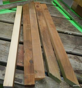

2 x 4's x 4' Qty 20 ( Lower Rail)
2 x 2's x 4' Qty 20 ( Upper Rail)
2 x 2's x 2' Qty 40 (Fence panel posts)

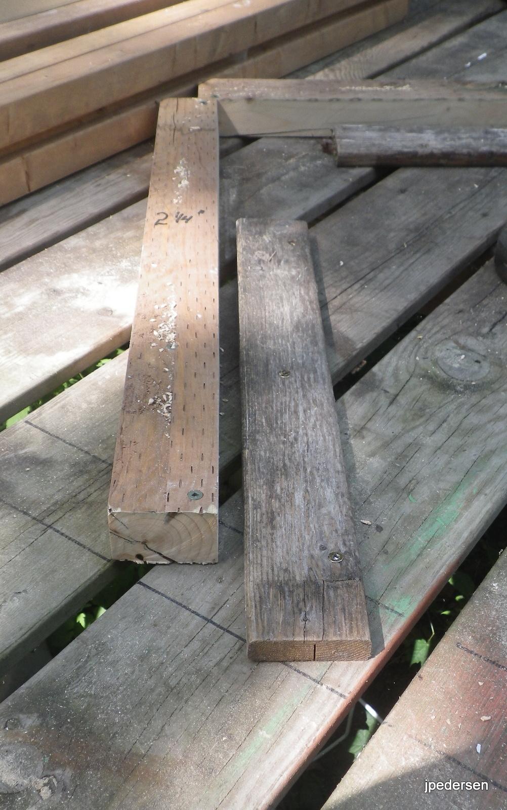

I laid it out so that the Top and Bottom rails are against the right hand edge of the pallet. There is a board screwed down to line up where the bottom rail goes, and another board screwed down to line up the top rail. Just above the top rail is another board that is where the top of the pickets align.
This is usually called a template or pattern board.

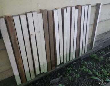

Before assembling the fence panels, each LP Elements Flat Top Pickets has to be cut into 3 two foot sections.
Begin by aligning the Top and Bottom rails against the screwed down boards, using a 2 1/4 " spacer from the edge, figure out where you want to place the first picket. Mark and drill two pilot holes for the Top and Bottom rails. Do not screw this down yet. Take this picket, mark the the top edge with a pencil and then clamp this board to three other pickets and drill the pilot holes so that the boards will look uniform. Save this board for future hole alignment of the rest of the pickets.
Take one the pickets with the pilot holes and place by the 2 1/4" spacer board that is on the Top and Bottom rails. Fasten to the rails with 1 1/2" wood screws.
Place a 2 1/4 inch spacer beside the picket the you just screwed to the rails, place a different colour picket with its pilot holes beside this spacer then screw it down to the rails.
Repeat until you have six pickets fasten to the the rails, you should have 2 1/4" spacing at each end and between each picket. Congratulations you have your first fence panel made, only 39 more to go.

I made a different Template Board to join the two fence panels together.
Step 5: Joining Fence Panels Together
After creating the template (holder) for the fence panels, I inserted the two fence panels upside down into it. The pickets slide into the slot of the template board.
I attached one fence post to the fence panel using 3 inch wood screws, 3 for the bottom rail and 2 for the top rail, pilot holes were drilled first. The fence posts keep the bottom of the fence rails about 4 inches above the ground. The manufacturer LP Elements, recommends a minimum 2 inches above the ground.

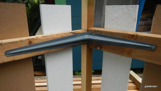

On the inside of the fence section on the bottom rail, I attached a 12 inch by 14 inch shelf bracket using 1.5 inch screws..
Attach another fence post to the other end of ONE of the fence panels. If this is going to be an end of fence section, attach a fence post to the other fence panel.
