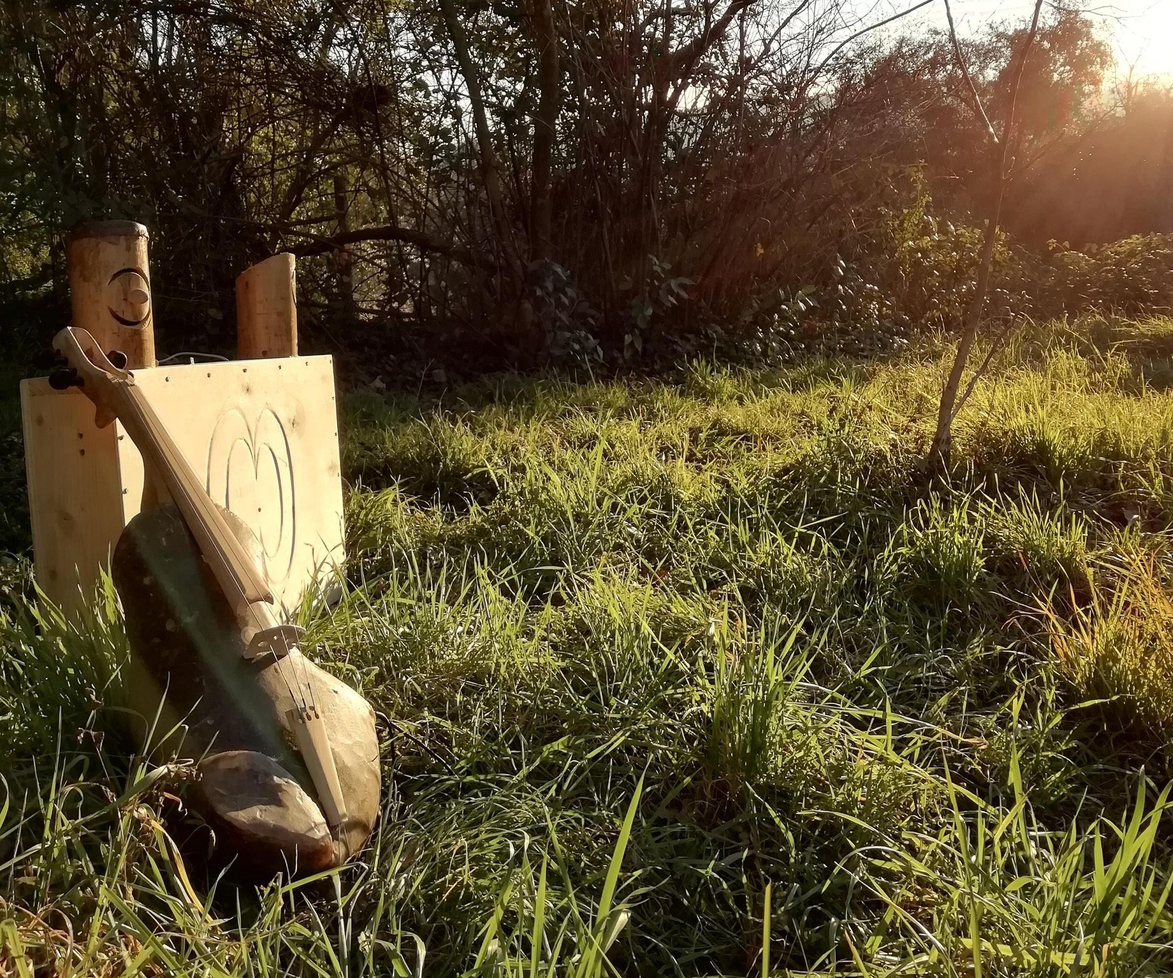

Travels are a never ending source of inspiration and most of the times I had to leave my violin at home because it was too complicated to carry such a delicate instrument with me. Finally, I've started creating a robust and modular version of a violin that I could put in a backpack.
More information on this website
The idea started during a travel in Africa while visiting different developing projects in the south of Tanzania. Later on, I've continued to develop the archetyp originally built during this trip, finding a way to amplify it, improve the proportion, keep the tuning...
After many different trials we have developed different models following some basic principles: Dimensions and proportions are the same of a classical violin.
-Violin maintainance is the same (same bridge, keys, strings...)
-The sound is generated from the vibration of wood, skin and metal (and not only from the strings)
-The instrument is modular and robust.
-The handle allows the insertion of different harmonic resonators, shoulder rests and electronic devices.

The handle is built respecting the exact dimensions of an acoustic violin and preserves the same references for the hand. It is usually made of oak, mogan, buche... The top has different forms depending on the kind of resonator it is built for. We particularly like the form of a crown pit. The total length is about 63cm. There is a reference attached to the left side of the handle to counterbalance the shoulder rest on the right side. Fingerboards preserve the original size and are usually made of padauk or olive. Generally we place a diamond shaped wood knot in the middle of the fingerboard. This peculiarity is typical of the olive wood.
-Shoulder rest
The shoulder rest can be embedded between the handle and the string holder. It's a single piece designed to sit on the breast and the shoulder. One can extract it to reduce the lateral size of the violin during the transportation. Shoulder rests are extremely customizabile according to the posture of the violinst. They are designed/dimensioned to balance the total weight of the violin and to shift the center of mass towards the body to release the load on the left arm.
-Resonator
At first, we have tried different kind of resonators made of bamboo segments, coconuts, pumpkins or more complex forms obtained by using wood slices. The most performant resonator was a bamboo segment whose lenght was the half of the total string length. This simple resonator was extremely rich in harmonics, and substain was long lasting. Without amplification the sound is gentle and does not disturb the neighbours. We have tried resonators with parts made of skin, metal, springs, to mechanically elaborate and enrich the sound.
