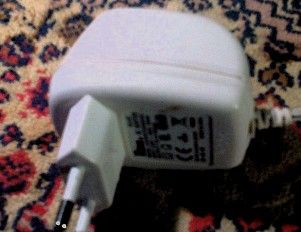

an old adaptor. (6-9 V, AC or DC - both of them are useable)

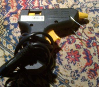

saw, drill, glue gun and perhaps a soldering iron (I have one, so I used it, but only a massive the wire wrapping is enough).

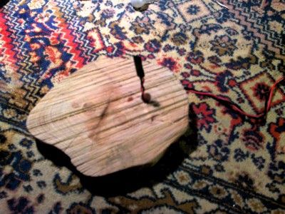

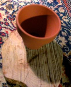

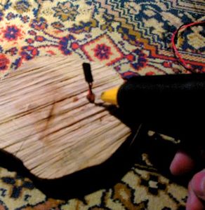

Cut a slice the wooden block (or butt), and drill a hole where you want to place the pot.

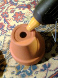

Put the wire up with its plug (which originally was plugged on the two pins somewhere on the mainboard) into the hole, and fix it using a glue gun. Then take the flower pot (there must be a small hole on its bottom, if not, you should drill it), and fix it, arranging the holes centrally on each other on the block, so you get a simple pot on an underside, with one co-axial hole.

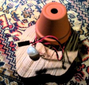

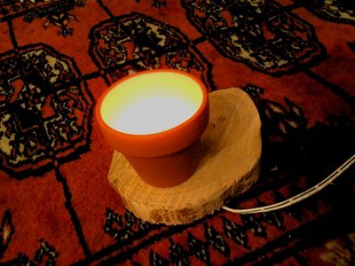

Now carefully pull off the small plastic piece from the christmas bulb to free the two naked electrodes of it - these will be connected into the glued mainboard-plug. Connect them firmly, and finally connect the adaptor (I cut the plug from it, and soldered the wires, and at the end glued the connections onto the backside of the wooden butt slice.)

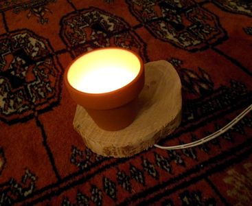

If you want to stand the lamp, you are ready now, to hang it, you should drill an other hole on the butt slice to fasten the lamp on a horizontal surface upsidedown.

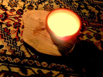

And that's all. The light of this small mood lamp seems to it is filled with warm light, and, when using it on a shelf, the direction of the light has some multidirectional feeling - as if the light would flow out from the pot.
On hanged mode the lamp is a simple dim spot lamp. Recommended to enlighten corners or shelves.
