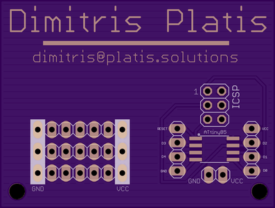

I got my initial inspiration from Frank Zhao’s USB PCB Business Card and Mike Puchol’s PCB business card, however I wanted something simpler to build. My idea was to make a small development board out of the business card, with an ATtiny85 microcontroller and its pins broken out, ICSP headers to program it and some available space for prototyping. Its usability would of course not be anywhere near that of an Arduino, however it could potentially be used to make something cool.

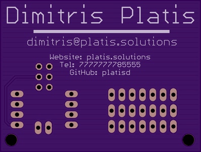

If you do not know and do not want to learn how to use such tools, then just save the pcb_business_card.brd file (right click + Save link as) and open it with your favorite text editor. Observe that it’s basically an XML file.
Find where I have placed my name (ctrl+F then type “Dimitris”) and then edit the appropriate fields with your own information.

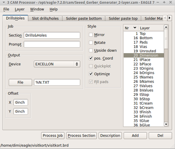

- Download the Seeed Studio's CAM file.
- Import the project in Eagle. You do this by finding where the default project folder location is and just putting the .brd file inside. In Ubuntu this is at /home/user/eagle, in Windows it is in the default Documents folder. If you want to keep things organized, you can put your project into a separate subfolder.

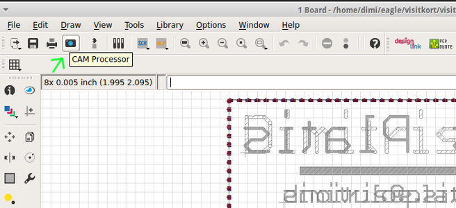

- Open the .brd (or .sch) file, in the board view, by double clicking on it.

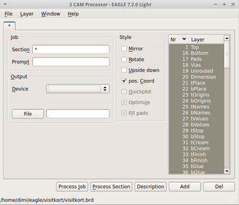

- Click on the CAM Processor icon.
- In the window that will pop up, click on File > Open > Job and pick the .cam file you previously downloaded.
- If done successfully, upon return, the window will look a little different. Notice there are more tabs now? If yes, click on Process job.
- And that was it. Go to your project folder and you will see that a bunch of new files were generated. Zip them and they are good to be uploaded!

If no other changes are made, your cards should look slightly better than mine. I improved the design, by exposing the copper on the front side of the board, so your name will look more metallic and shiny. Another change I made was to add VCC and Ground pins to the prototyping area on the left. Last but not least, I removed my logo, so you won’t have to do this yourselves. Moreover, keep in mind that if you choose to fabricate your cards at Seeed Studio, they will print a reference number to the rear (bottom) side of your PCB, which might not be the most aesthetic feature on a business card.
To conclude, this is a very easy project which can make you stand out from the crowd, with little effort and money. You can even hand them out without the microcontroller if you want to lower the cost and the size. It should not decrease the wow factor.
Finally, this is how the card looks after soldering some pins on it. Cute, isn’t it?
