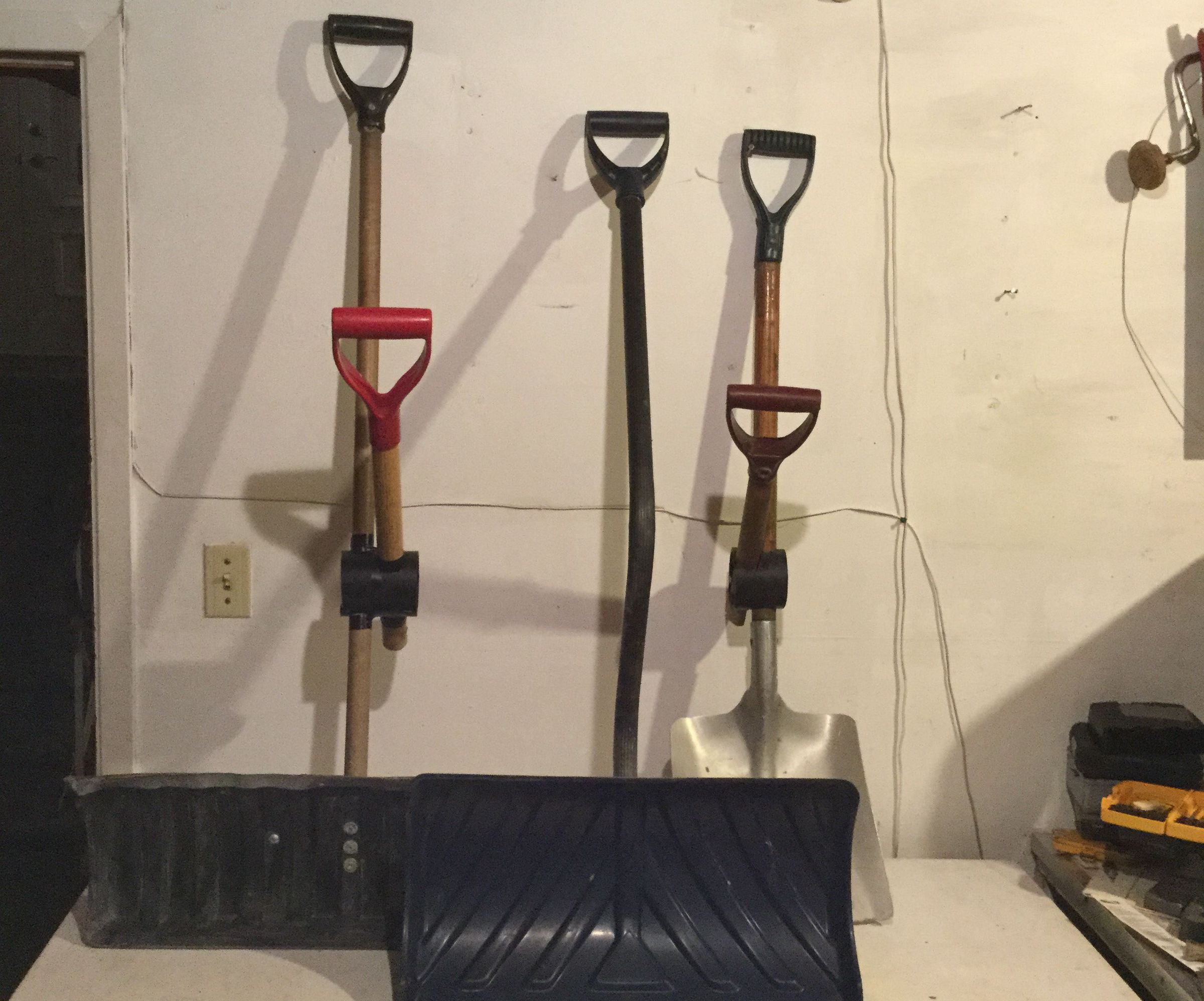

Here, in Sherbrooke City, in the province of Quebec, Canada, we are again today, saturday, april the 13th 2013 , in winter season. Season's greetings! So I prefer to not see outdoors, but may be it's a good idea to think about the next winter who is not so far! So I see my used snow shovel and say: "You gave me good services during all those last ten winters and with all the cares and face lift I gave you, by example a better fix for the handle and a metallic blade (scraper) fixed with pop rivets to protect your plastic flesh, it's not easy for me to divorce with you! But now, after two used metallic blades,your flesh is worn and it's time to go to the recycle bin".
But I have a certain "retenue" and I think that the best for the planet is to reuse. Reuse is the best recycling process. I say " Now it's time to see what is your future my darling shovel." You can see the bad side of my shovel with the metallic used blade and the upper good side that I will use after the next steps..
So I observe that like many shovels in the market, my shovel have some symmetry or near symmetry. Would it be possible to just reverse the handle and have a new shovel and many years of happiness together? Yes! See it how now. May be you can rejuvenate your shovel like me ( it can be also in aluminum or iron). May be it's possible for snowplow...We can shovel money or raking it in our wallet by recycling! May be you consider this instructable for rejuvenate shovels a good candidate for the indestructible contest. But there is a problem, all those contests are closed to quebecquers. Why? Do you think you want to vote for me. Ask them to the guys at Instructables. I have a consolation price: may be in may we can have snow again and my indestructible shovel is ready!
Materials : 3 wood screws, 2 machine screws with nuts and washers.
