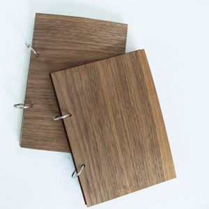

With all that in mind I decided upon the design of it I'm going to show how to make here. While your needs and tastes will probably be different, the making process is probably going to remain fairly similar.

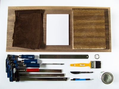

Since I'm entering this into the DIY University contest, it's pretty simple!

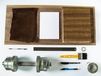

Tools:
X-acto or any sharp knife;
Pencil and maybe a thin marker;
Standard 2 hole holepunch (didn't make it to the photoshoot in time, as you can see);
Paintbrush (gluebrush in this case)
Clamps, weights or, in a true student fashion - books;
Hard flat surfaces bigger than desired cover size for clamping;
A piece of sandpaper, anything 300-500 grit should be good;
Ruler;
Materials:
Wood veneer, in my case - walnut (area of at least 4x the desired cover size);
Leather (area of 2x the desired cover size), any non-absurd thickness should do;
White wood glue or contact adhesive, also some super glue;
Some paper of desired size;
2 book binder rings;

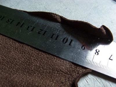

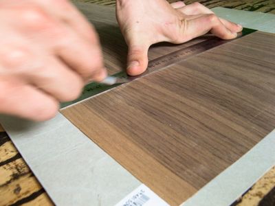

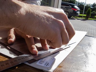

Step 2: Mark and Cut the Veneer and Leather

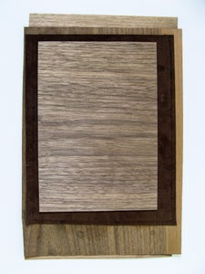

Find decent sized pieces of wood veneer and leather. The cover is made by gluing together a layer of leather with two layers of wood veneer which have a grain direction perpendicular to each other to avoid warping of the covers. As for the leather - you have to decide which side you will want visible. The leather I used had a beautiful soft suede side which looked and felt way better than the other one so I went with that.
Cutting can be done without marking anything, but I made some lines with a pencil just for the sake of it. It is wise to cut the initial layers at least a bit bigger than the intended size (which should be a little bigger than the paper to be used size) to allow for trimming and some unexpected error unless you have a PhD in gluing perfectly sized surfaces together perfectly. A sharp knife of some kind should be enough for proper cuts. Just remember that when cutting veneer cross grain it will probably split if the blade catches somewhere (hence the need for sharpness) and when cutting with the grain the blade will have a tendency to go with the natural grain direction. There are several ways to avoid that. First and foremost apply lots of pressure on the ruler or another straight edge you're using as a guide so the veneer under has no chance of moving mid-cut. I also found that a rounded blade helps with the splitting while cross-grain cutting, but so does using more lighter strokes with almost any other blade. If you have some spare area of veneer it's a good idea to try some cross-grain cuts before the ones you really need to make to see where (if) you go wrong.
As you can see in pictures I also trimmed the leather in places where it was folded upwards. Not a must, but a good idea to do so if you don't need those areas because they might mess up your gluing and clamping part a bit.

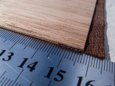

Step 3: Gluing the Sandwich
Now that you have the layers for covers cut it's a good time to glue them together.
The glue choice is up to you, but now that I've tried both white glue and contact adhesive for this I'd go with wood glue if doing this again. Here's why:
It has no nasty fumes (forget application, the glued cover needed 24 hours before I took it to my room);
No difference in warping afterwards between the two glues;
It is easier to work with: you can reposition layers before clamping, if needed;
It's easier to apply;
Seems like there's less tension between layers when using wood glue, since it allows the tiny bit of movement when clamped;
Easier to clean off if gets where it shouldn't.

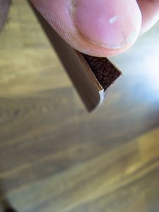

Disadvantages of the wood glue are that at least to me it feels like trimming the covers is harder if glued with wood glue and it has less strength and is more difficult to apply in such a manner that every spot is glued perfectly, hence the spots where you have to fix stuff with super glue. No big deal for me, but it's for you to decide.
I believe there are some wood glues that dry hard and brittle as opposed to elastic, that should help with the warping. I'm tempted to try epoxy as well for that reason, but a little afraid it will seep through the veneer and leather. Also a clear coat over the veneer might help, but again, I want my notebook cover to develop unique patina from use over time.
If you do have it, however - spray contact adhesive should be really easy to apply. An even easier way to go might be adhesive backed veneer as I mentioned earlier. I can't guarantee that these suggestions will really work, though, because I haven't tried them myself.

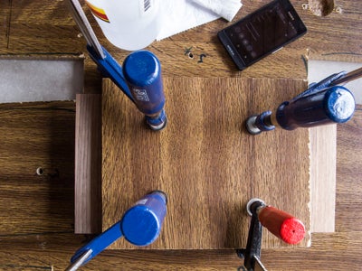

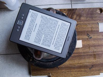

For gluing the covers flat you need to clamp them between two flat surfaces. I used some pieces of a laminated MDF board which I had from deconstruction of an old wardrobe. For clamping use what you have. As you can see I had enough F clamps for one of the covers, yet needed to improvise for the second one for which I used some weights (44kg in total) and added a lot of books on top, just to be sure. I glued these in the evening and removed from the press next morning, ~12 hours total. The glue instructions state 30min clamping time as enough and 24 hours for a maximum strength bond so read the label of whatever you're using and act accordingly.

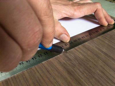

Step 4: Trimming the Glued Covers

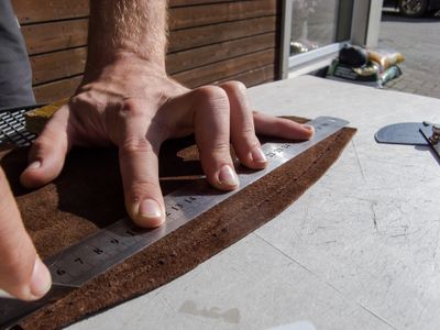

After some time has passed and you've taken the glued, yet untrimmed covers out it's time to trim them. First of all decide upon the size the cover is going to be. Making them the same size as the pages intended is not a bad idea, but I prefer them just a little bit bigger. If you look at hardcover notebooks it's almost always like that and that seems logical for me as well. Since I intended to use A5 sheets which officially are 210x148mm (148.5 maybe) I went for the cover size of 215x151mm. That's an extra 2.5mm in every direction, except for the one where rings are going to be, because you'll need to punch holes there.

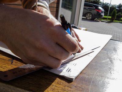

Trimming itself is a fairly simple deal. Take a sharp and thin knife - I prefer x-acto with a rounded blade for this. It's not a bad idea taking a fresh blade now if the one you have used seems not too sharp any more (you can get more life from the used ones using a smooth ceramic whetstone of course). For the first cut there's no need in marking anything - eyeball a somewhat straight cut (use ruler for cutting, of course) in a place where all 3 layers are present. If you want to get rid of some glue which you got on the cover or something else bad looking - first cut is the time to do that. After you've got the first cut done, mark two lines going perpendicular to the first cut which in my case are 215mm apart.

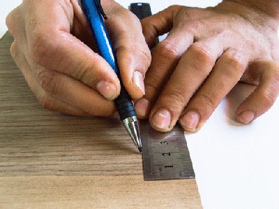

A good way making perpendicular lines without a square is using a ruler which has markings on both sides: first set it along the edge and make markings at intended distances, then place the other side of the ruler with matching distances at the dots and make more markings on the side where there are none. If you repeat that several times there will be like 4 dots in line over which you draw the lines on both the top and the bottom for the cut and later cut along those lines. The gif in this step should explain that if there's the need.
Mark the intended distance along the two straight parallel edges now, in my case 151mm, probably draw a line between those and cut. You now have a nice cover for your soon to be notebook. Repeat the same for the second one.

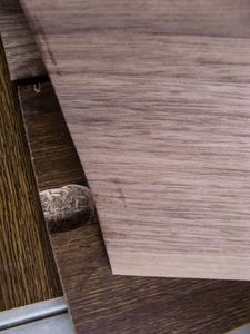

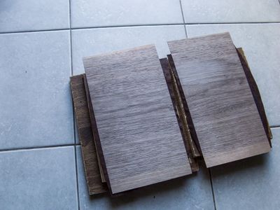

Enter the failure: Since I didn't want to take another sheet of veneer while cutting layers I made the middle ones quite small (around the size of page +4-5mm in every direction), then, when gluing one of those I also had some misalignment and since it was contact adhesive and repositioning was almost impossible I glued it that way anyway. Not the best case scenario. So when trimming the edges and measuring for the last one I spotted a major issue - the middle layer was shorter than I needed (see 5th picture in this step) and I had to go back, find more veneer and leather and glue another one together. So don't be like me - leave a bigger margin for error. No big loss other than the time of course, since I should be able to make a phone case or something similar from this too small cover.

If after trimming the covers you see that the leather and glue is not neatly stuck together somewhere (very real when using white glue) take something sharp - like a toothpick, and with the help of that apply super glue between the problematic layers. If it fits, you can use the long neck super glue has for application, just make sure not to put super glue on the visible areas of wood or leather (sides doesn't matter that much) because those spots will be visible and can ruin the looks.

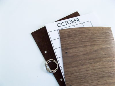

The covers are now done, you have your rings somewhere and maybe even some pages to put inside, so what's the deal here, you may ask. Nothing much, if you like all of that as is - assemble and enjoy (and maybe vote for me in the contest as well).

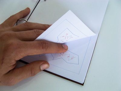

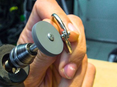

In my case there are some issues however. I prefer my binder rings to fit through the holes of more than one page at a time. This enables positioning the notebook in a cover to cover position easy and fast. Since the binder rings didn't fit I used a Dremel tool with the 425 polishing disc to shorten the hinge pins a little bit. A file and/or sandpaper should be good instead of the Dremel for the purpose.
Also a little something for those, who don't have binder rings widely available for purchase locally (like me, I ordered these from China and waited for 1.5 month for them to arrive). It is possible to make a simple and interesting version of them yourself by cutting open a metal ring from a hardware store (pick adequate diameter to fit through the hole) grind it a little bit so the cut surfaces face each other and then use neodymium magnets to attach the halves together. I cut 4mm rings and used 4x4mm cylindrical magnets. See 3rd picture in step. I also made and used rings made from a stainless steel cable for a while, but they had several major issues.

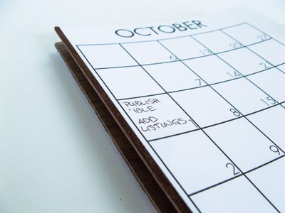

I also like to have some simple organizational ability in my notebook apart from the empty pages I use for ideas, sketches and whatever else so I designed some simple calendar pages and a squared page. All of those are attached here in .pdf format: pages with remaining months of the 2014 as well as all of the 2015 and a page with standard squares, but you'd be better off punching holes in preprinted sheets if you need those with squares I suppose. The calendar pages have Monday as the first day of the week, but the pdf's are all vector based and should be editable in a vector editor so you can change that. As for printing - they are meant to be printed on an A4 page size on both sides of the sheet while flipping over the long edge (select that in print setup), I prefer my calendar pages on a thicker paper, something up to 200gsm since they get thrown around more. The margins left in the file shouldn't exceed what most printers are capable of, so you can print A4 in original size setting. There's plenty of space left for holes as well. If anyone has the question - font used is Futura LT Book.
