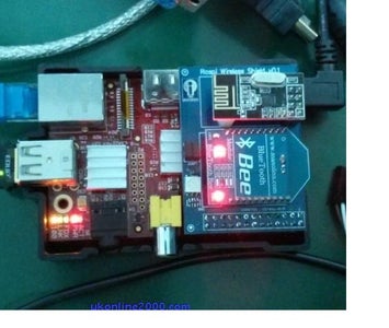

Introduction: A Novel Design for Raspberry Pi Wireless Shield Extension Board
Recently, we design a type of raspberry pi wireless shield (or extension board) for raspberry pi. By using this rpi shield, you can conveniently control your objective, like LED, TANK, CAR, etc. In this example, by using this wireless shield, we control the LED lamp to breathe.
the video can be seen at: http://youtu.be/kgt7f3D9FCM
the rpi shield is at http://www.smartarduino.com/raspberry-pie-pi-rpi-wireless-shield-support-zigbee_p93897.html
Step 1: Main Functions
Main functions:
1. Support XBee low power wireless module, and the Bluetooth module with XBee interface;
2. Support NRF24L01/NRF24L01+ low power 2.4G wireless transceiver module;
3. Support RFM12B-D (315MHz, 433MHz, 868MHz, and 915MHz) wireless transceiver module;
4. Integrate RGB LED light, by the soft PWM of raspberry pi GPIO, can control the colors and brightness, also can control the colorful breathe lamp, together with the wireless module.
