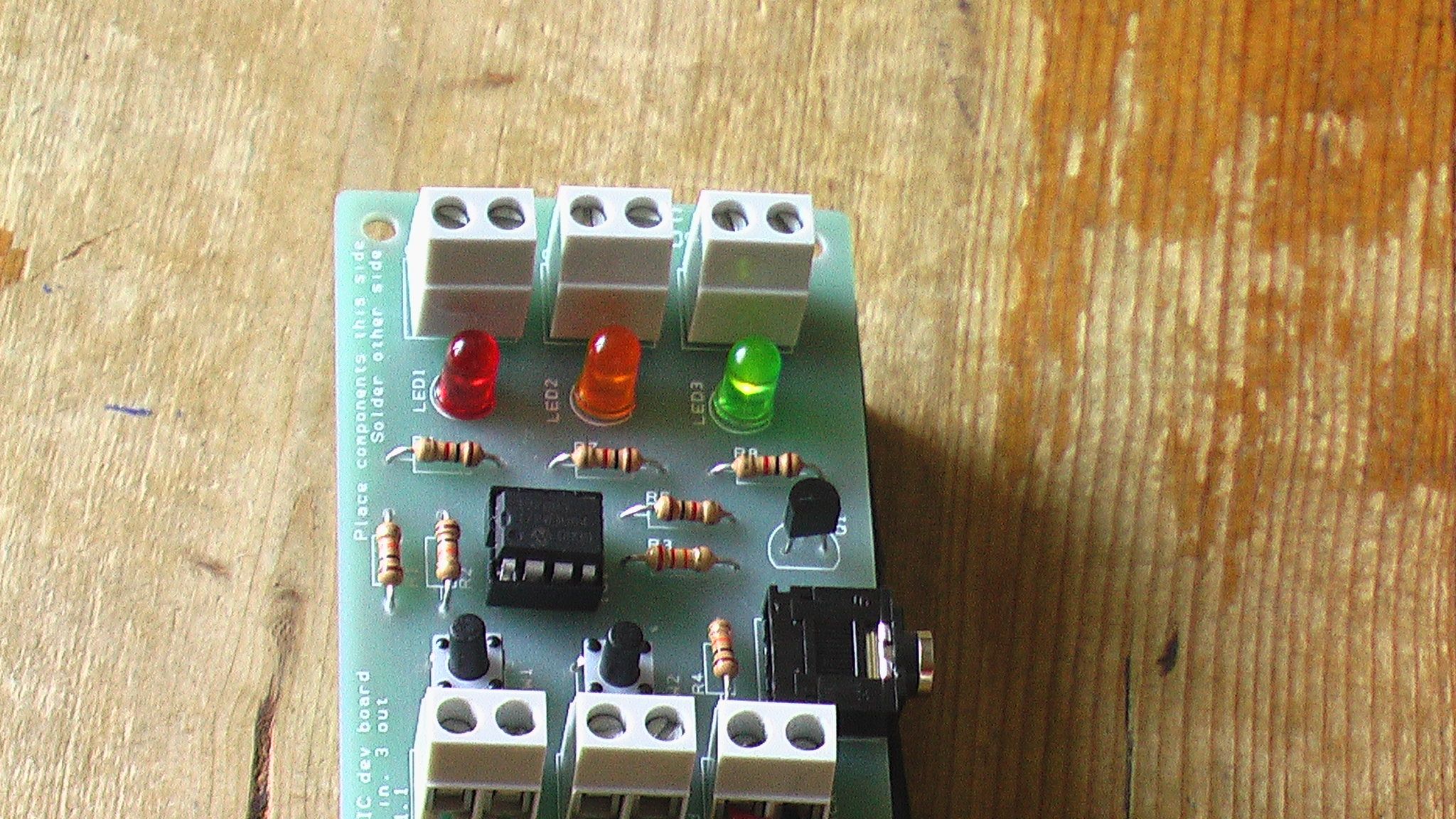

This is an alarm clock that does not tell you time but when the time reaches a given point the alarm goes off. A buzzer goes off and soleniodes push the top off the alarm. To turn off the alarm the top, which is a puzzle, must be placed back on the right place. It works as the puzzle acts as a jumper lead across the buzzer so it is not one even though power is being applied. When the solinoides are activated, in my case at 7:00 am, the puzzle is pushed off beaking the jumper circuit, turning on the buzzer. I have used 2.5 A2 sheets of 3mm acrylic plastic sheets, 1 picaxe 08M and 08M board, 1 buzzer and 4 solenoides. The chip runs off 4.5 DC V. In the code below the buzzer is attached to output 1 and the solenoides are attached in paralel to output 2. The code follows;

If you want to make your own I hope this explains how I made mine.
