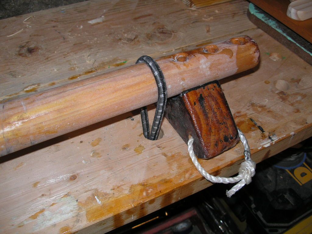

However, the vise is situated well. See the dowels poking out the side? They support planks edge-up for edge planing and beveling. I had two rows to take 4-6 inch and up to 11 inch planks. Add a spacer so that the planks lay flush with the back of the vise, or rabbet the vise in flush.
