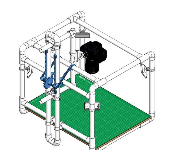

Introduction: A2 Overhead Corner-LEDs Lightbox
This lightbox was created for documenting small parts - less than A2 in size. It features an adjustable height mechanism and the ability to center different style cameras. The angles and height of the illumination can be set, as well as its intensity. The frame of the photos can be square and share a common scale and lighting.
It does not remove shadows - it makes more less intense shadows. For softer shadows see the softbox wrap extension Instructable.
It is made from 20mm water pipe and fittings, MDF, wiring/LEDs and 3D printed ABS parts. The construction of the ABS parts are documented at Thingiverse (links supplied).
The samples provided are quite rough. I will post updates as I configure the camera / lighting better. The images labelled "softbox" are taken with the softbox extension [here]. There is also a platform extension [here].

Step 3: Assemble the Base
- Assemble 2 off PVC T-Connectors to a 538mm PVC pipe using the middle opening on the connector.
- Repeat the process to have a front and back member.
- Attach the front member to the back member with 2 off 316mm PVC pipes.
- Secure 4 off 39mm PVC pipes into the remaining outer openings on the T-Connectors.
- Ensure all pieces are tightly joined and the whole assembly is "in-plane" (not skewed).
- Position the PVC base onto the MDF sheet; center it.
- Drill 4 off 2mm holes through the PVC into the MDF in the positions shown, careful not to go completely through the MDF (optional).
- Fasten 4 off #6 35mm button head screws through the PVC into the MDF.
- Drill 6 off 2mm holes through elbow and secured PVC pipe in the positions shown.
- Fasten 6 off 4G x 9mm button head screws through the holes just drilled.
- Join the corners to the 39mm PVC pipe,; push in completely; point loose bends upward.
- Place the cutting mat on the MDF base. It can be secured with double sided tape (optional).

Step 5: Assemble the Camera Positioning Frame
- Join 2 off PVC elbows with a 39mm PVC pipe joiner.
- Repeat to create 2 off vertical adjuster ends.
- Add 1 off 712mm PVC pipe to each (2 off) openings on vertical adjuster ends.
- Add ABS 90 degree locking coupler with the knob facing down.
- Place the lightbox on the edge of a table so that the vertical adjuster can extend downwards.
- Take the U-section created above above, and feed the loose ends into the upper ABS 90 degree couplers.
- Before passing through the lower ABS 90 degree couplers, add the other ABS 90 degree locking coupler with the knob facing up.
- Continue feeding the loose ends into the lower ABS 90 degree couplers.
- Use remaining joined elbows in #1 & #2 to fix onto the bottom of the U-Section (closing the loop).
- Slide 90 degree collar onto the 250mm PVC pipe. Ensured it is fully inserted (without obstructing the cross pipe) and fasten with 1 off 4G x 9mm self tapper pan head screw.
- Repeat #10 to create 2 off camera horizontal adjusters.
- Slide 1 off 400mm PVC pipe into the remaining openings of the 90 degree collars.
