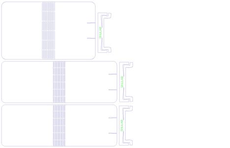

Step 1: Format Change
First of all i changed the format from the sketch map from a4 format to a3 format.

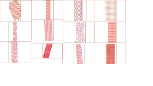

Step 2: Different Pattern Samples
I made different test patterns and checked wich one bend the best. After the test I made my discision wich pattern i u would use.

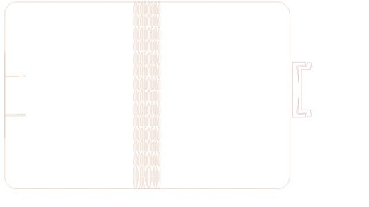

Step 3: Laser Cut File
After the format change and the pattern test I made my drawing in illustrator. wich i will upload here.
Step 4: The Result
I uploaded the file in the laser cut progame, after 10 minutes it was done, and i was happy with the result.
