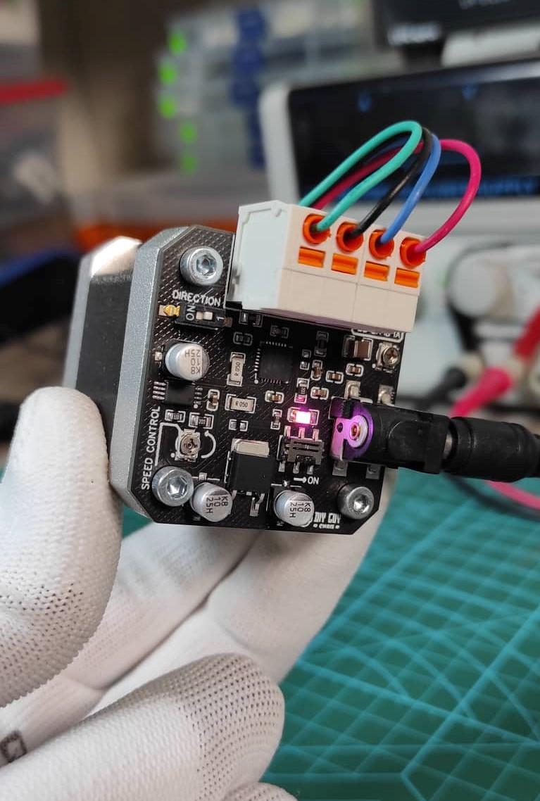

The heart of our circuit board since eveything is turning around it, I refered to the setup provided by Polulu Robotics & Electronics where they posted the tested circuit setup for their designed shield and here I followed the same setup (same parts values) in order to get the same functionalities, I just adjusted the input net of STEP pin that I connected to the output pin of NE555 and I place a slide switch to the DIR pin, also the slide switch is an SMD one to save space on the Printed Circuit Board. The outputs of A4988 circuit will are connected to a "quick-mount" terminal block where we will wire the Stepper coils wires.
Schematic PDF is available for download through the files section
Convert to Printed Circuit Board (PCB)
After getting the Schematic ready I then converted it to a PCB design, I check the Nema17 drawing for the exact stepper size measures to draw the board outline of my circuit board since I manage to place the module at the back-side of the stepper motor and make it looks like a true shield.
I then brought the components to the board area and arranged them in the appropriate layout, I considered to keep the parts of each same block closer together because this will help me later while routing the circuit board.
I also drawed a 45 angle degrees copper pour area around the top layer to act as a heat dissipation for A4988 chip.
A track width of 0.254mm is suitable for the connection nets, I used a 0.5mm track width for the 5V, 9V and the motor outputs since these tracks will carry a higher current.
After finishing the PCB routing I generated the GERBER design files and send it for manufacturing.
Step 4: Shield Assembly
In order to produce this Shield I moved to JLCPCB where I uploaded the design files (GERBER) to their website for PCB and Stencil order (the Stencil will help me deposit the solder paste equally on the board, this is just an option so you still can produce your shield without the use of Stencil).
I selected the Black color for the Board and the Golden Nickel surface finish, no purpose for my selection so you could go for the most appropriate settings of your choice based on your budget.
At this level you will use the supplies that we posted on the "Supplies" section, first you need to stick the PCB on a flat surface and then stick the Stencil above it to keep the pads exposed, you then drop the solder paste on the Stencil and use the Spatula to deposit the solder paste, once you remove the Stencil covering the PCB you will get the solder paste covering the exposed pads and no extra solder paste around these pads.
Now you place the electronics components each one to its place on the board and use the Hot-Plate to heat the solder paste and get the electronics components soldered.
This technique is for the SMD parts, about the Terminal block you will use a solder iron for the assembly of this part.
Once you get the Shield assembled you will notice the purple LED lighting up as soon as you plug-in the power supply connector to the board's main power.

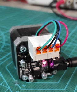

Now we unscrew the Nema17 housing and we place the Shield to its back-side then screw it again, the last step is connecting the Stepper coils ends to the terminal Block following the label that I draw on the Shield as a coils connection guide.
Step 5: Testing the Shield
After getting the Board very well assembled, I plug-in the power supply cable coming from a 9V DC power source and the stepper starts spinning, the Speed is controlled through the rotary potentiometer and the direction is controlled through the direction slide switch.
