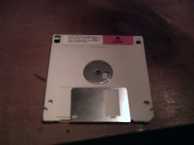

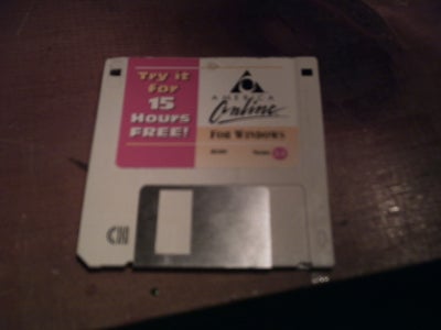

Step 1: Dollar Bill Holder
First we start off making the dollar bill holder. I had already made it, but just follow the steps I lay out before you and refer to the photos below and you can easily make one too.
1. First of all, get an old A: disk that you don't care about (hence the AOL disk).
2. Insert a flat head screwdriver into one of the sides of the disk (through the seam).
3. Gently pry the disk open (top and sides). Leave the bottom attached. If anything falls out, find it and put it aside.
4. Using a small piece of a toothpick, prop the disk open as shown in the photos.
5. Take out the metal disc from the inside and using scissors, cut all the black material off the metal disc.
6. Glue the disc into the groove that it belongs in. Also glue the "write/locked" tab in the corner onto the track it came from.
7. Allow glue time to dry. Start warming up your soldering iron.
8. Once the glue has dried, take your soldering iron and melt a hole in the center/top of the disk (on the inside). Do the same on the opposite side (once again, on the inside).
9. Glue the magnet into one of the holes. Allow it to dry.
10. Flip the disk over and either glue a small piece of the ferrous scrap metal into the hole or another magnet (depening on how many bills you plan on placing in each disk). Allow glue to dry.
After the glue has dried completely, you will have you're very own dollar bill holder. Just slide the money in and close the "clasp" of the holder...

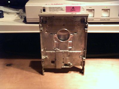

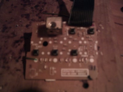

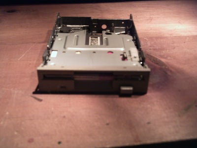

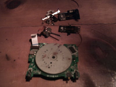

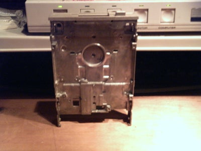

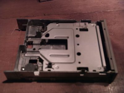

Step 2: Gut the Drive
To make room for the LEDs, we begin with the simple task of gutting the drive.
1. Use a flat head screwdriver and pry off the protective metal cover from the drive.
2. Remove all the screws using a star head screwdriver (except the one seen in the 4th picture at the bottom right).
3. Take out all the electrial circuitry, but leave the disk ejection mechanics alone.
4. Test out the drive to make sure the disk will eject correctly.
Keep the face plate on the drive.
P.S.- Do as the disk says in the last picture of this step...

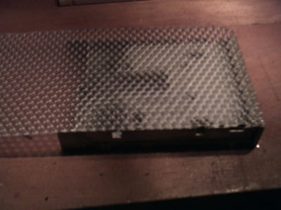

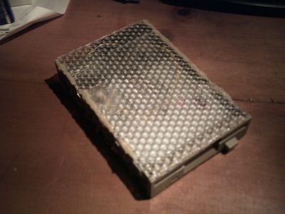

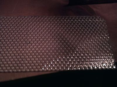

Step 3: The Covers
Now to make the LED diffusion covers for the bank. Do in a well vented area!!! Do NOT breathe in the fumes!!!
1. Place the light diffusing panel on top/beneath the drive and trace out the design using either a marker or the soldering iron.
2. Melt the design/outline halfway through the panel using the soldering iron. Now just gently "snap" the panel at the melted areas.
3. Do the same for the other cover.

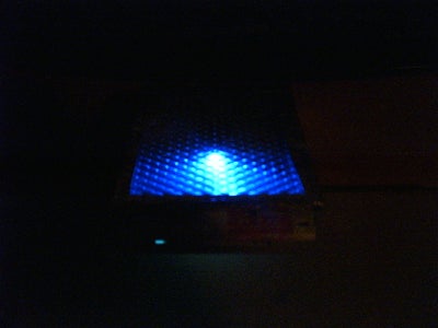

Now that we have the two covers for the bank, we can start hooking up the LEDs...

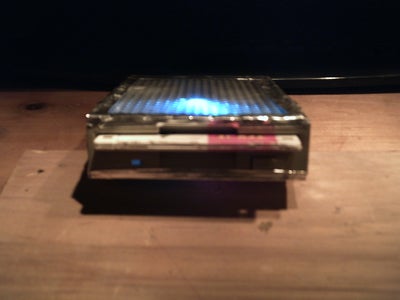

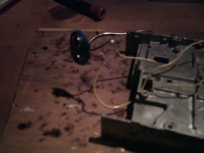

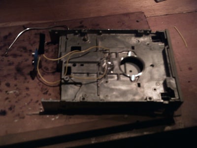

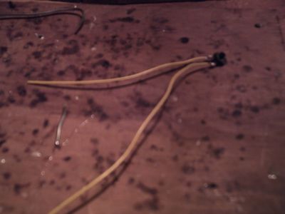

Step 4: Wire the Switch and LEDs
After figuring out which side of the LEDs is positive, make sure they work and decide how you want to hook up the circuit. I'll show you how I hooked mine up.
1. Take one of the blinking LEDs and solder the 100 ohm resistor to its positive leg.
2. Figure out where you want to place the momentary switch. I decided to use the ejection surface of the drive since it rises and lowers onto the disk.
3. Solder a wire onto two of the legs of the switch (make sure they aren't the always on legs).
4. Solder the negative leg of the other LED (the one without the resistor) onto one the the wires attached to the switch.
5. Glue the switch onto the area you picked out for it.
6. Glue the LED near the center of the drive.
7. Thread the wire down through the drive to the other side. Remember to leave some slack to allow the drive to rise.
8. Thread the wire attached to the switch down to the bottom (away from the face plate).
9. Solder that wire to the negative wire of the 9v battery clip.
10. Solder the other wire (attached to the LED) to the negative leg of the LED with the resistor.
11. Solder another wire to the resistor.
12. Glue the LED and resistor to the center of the drive.
13. Thread the wire to the bottom.
14. Solder the wire to the positive wire of the 9v battery clip.
15. Tape the wires attached to the 9v clip individually and then together.
16. Allow all the glue time to dry.
The wiring is now done. Next we attach the covers...

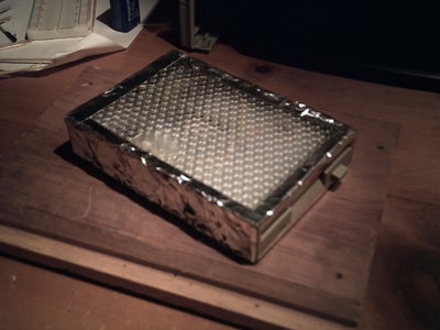

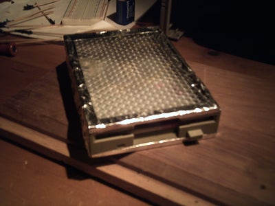

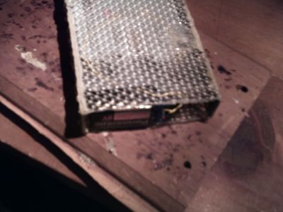

Step 5: Attaching the Covers
This is a simple way of attaching the covers. You could also drill and use screws.
1. Using strong glue, trace along the top of the ridges of the drive around the outside.
2. Position one of the covers (flat side facing out) on top of the drive. Use more glue along the edges once you've positioned the cover. Be careful not to get the glue on the inside of the drive, otherwise you have a chance of stopping the ejection mechanism from working. Don't worry about how it looks cause the tape will cover it up.
3. Allow that side to dry.
4. Repeat for the other side.
5. Insert the disk (after glue has dried) to make sure the drive still works. If it doesn't, use a screwdriver to pop off the covers and scrap the dried glue off. Try again.
6. Test out the covers once they've dried to make sure they're secure.
7. Make sure the switch is hitting the cover which will turn on the LEDs. If it isn't, glue a small piece of plastic to the inside of the cover and test it.
8. Tuck the 9v battery into the nook in the bottom of the drive.
Now that the covers are on and the LEDs work, let's add some trim.

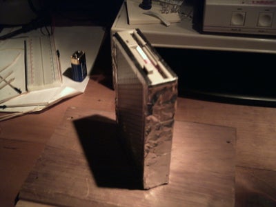

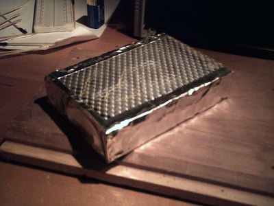

Step 6: Add the Trim
Now to add the trim to make it look all nice.
1. Take the foil insulation tape and cut off pieces long enough to cover the sides of the drives.
2. Peel the backing off the tape and attach the tape to the sides. Press the tape firmly onto the sides, top and bottom of the drive.
3. Next cut a piece of tape to fit the back of the drive. Peel the backing off the tape and fold over a small section of one of the corners to make a tab. This tab will enable the back to be pulled off to replace the battery. Now press the tape onto the back of the drive and onto both the top and the bottom covers.
4. Cut small pieces of tape off to use for the front panel. Peel and position the tape over the front panel to cover up the gaps along the edges. Press the tape on firmly.
5. Use the exacto knife to even the edges of the tape on both sides of the drive. Peel off the excess tape.
You now have a functional dollar bill bank. Enjoy!!!
