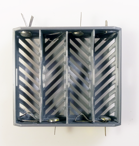

Hello everyone! This battery holder is designed for quick and easy 3D printing while keeping a cute and practical design. The lid uses a clip system to stay securely closed, letting you mount the holder in any position – even upside down! It also includes two side covers to hide connectors, with multiple holes for cable exits.
This set includes files for a 4xAA battery holder, and I've also provided STL files for 2xAA and 3xAA holders.
Hope you find it useful for your projects!

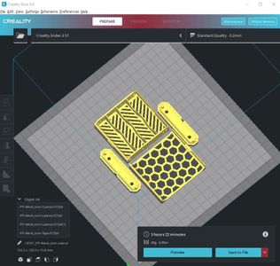

Step 1: Files and Printing

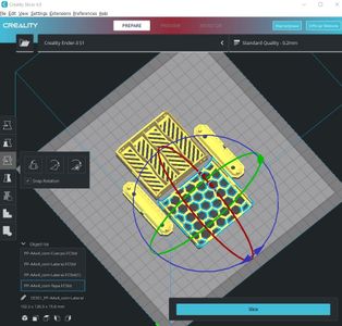

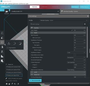

I use an Ender 3 S1 with "Standard Quality" (0.2mm) for generic PLA. No additional special settings or supports required.
Here are the stl files. You will have to rotate the lid and side covers for the printing.

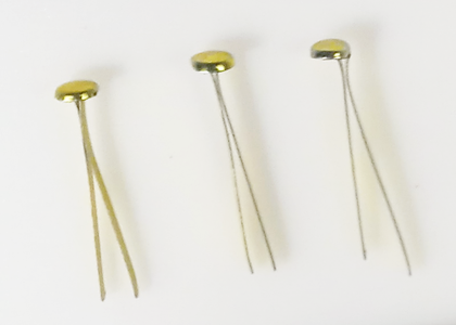

Step 2: Connectors
Meanwhile, the boring and dirty step. The fasteners come with some coating that you need to remove to ensure a good connection with the batteries. We need 5.

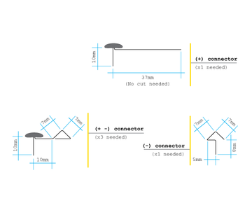

Step 3: Folding Connectors
Now you have to fold 1 connector for the possitive (+) connection, 1 for the negative (-) without the "head", and 3 for (+-).

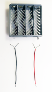

Step 4: Attaching Connectors
When you look at the body, some of the battery dividers have a tiny space between them and the side wall to hold the (+-) connectors.

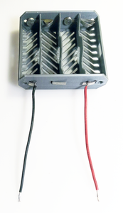

Step 5: Wiring
Simply connect the (+) and (-) connectors to the wires and secure. You can also solder it if you like.

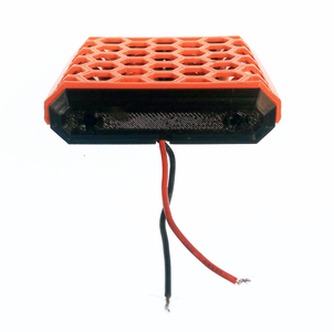

Step 6: All Together Now
The side covers are symmetrical so you can rotate it.

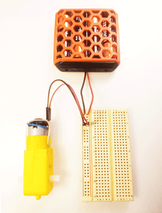

Step 7: Testing
