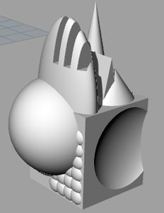

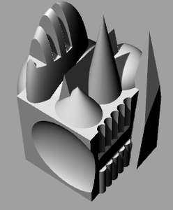

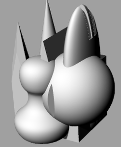

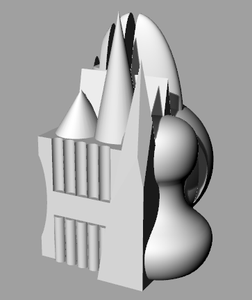

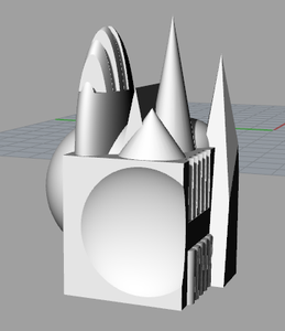

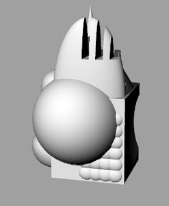

I printed the form with various kinds of surfaces, edges, points, and shapes to see if the acetone will have different effects on them.
Step 1: The Form
I made this form to see the effects of the acetone on different types of shapes.
It has:
  • cones
  • pyramids
  • concaves
  • round
  • organic
  • scale texture
  • pointy & dull cones
  • prism
  • channels & valleys
