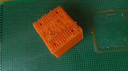

The above reasons are trouble me a lots. Finally, I want using a FRA epoxy ordinary single side 1 mm holes PCB board as my printing bed is the best solution. You can buy it any where with just $1 for a 90x220 sq. mm size. You can watch me it Fig 2 and Fig 3

6. The speed for the first layer should be slow (15mm/s) and you can see the ABS will keep to flow into holes and finally form a path, shown in Fig 4.

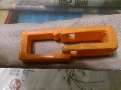

Fig. 5 shows my ABS model printed with “holes-holes board” and that is perfect indeed.
Sometimes it sticks on the board so strong and you should pull it up vertically with force. The 1 mm scar on the bottom can be easily cut it without difficulty, Fig 6. At last, you can pin out the ABS residues and reuse your board later.
