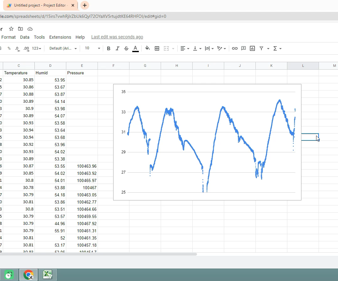

If everything runs smoothly, the result will be shown on Google Spreadsheet as picture. In this project, the data of 1 day will be saved in every sheet from 00:00 to 23:59, so we can read it very easy and prevent data lost (because 1 Sheet is limited with specific rows)

Then, plug the power for ESP8266 and now you can monitor your home appliances (the graph in Google Spreadsheet is drawn manually by me, you can do it)
