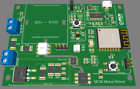

Step 4: PCB Design and Ordering
For the implementation of a good project we need a reliable assembly for the circuit that makes it up, and there is no better way to do it than with a good PCB.
Here you can download the Gerber, BOM and Pick & Place Files, the ones you need to order your PCB on your PCB manufacturing company.

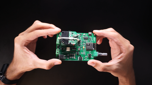

Step 10: Testing the Project (Enjoy)
As you can see, now you are able to control your dimmable light as you want from a local network or from anywhere if you enables the DNS of Home Assistant.
As you can see in the multimeter the waveform is trimmed accordingly to the dial position giving a brightness feedback and obviusly we can evidence it in the shine of the actual bulb.
This can be applied to control AC motors, heaters, lighting (could be LED dimmable lights also) and every load you understand can handle this kind of waveform.
Pd: I've tried this with ceiling fans and it works very well.
