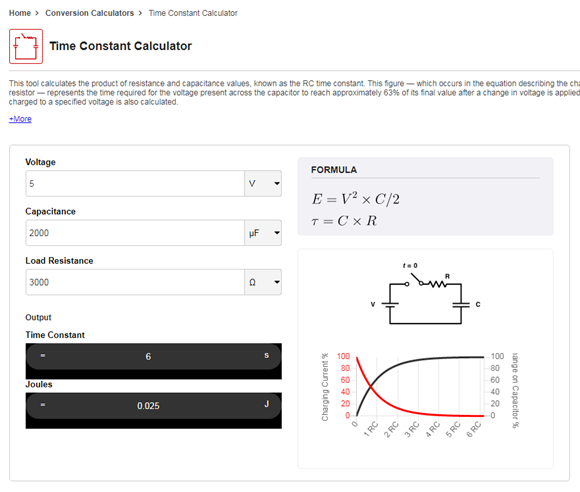

Step 11: Generator #2: RC Circuit
We can use the generator #2 to mount a simple RC circuit to light off two leds.
Using the time constant calculator from here we can design the circuit to maintain the leds on.
This time I have used R = 3000 ohms and C = 2000 microfarad, so the lights will be on at least during 6 seconds as you can see in the video.
You can propose your students to design RC circuits to maintain the leds on during a specified period of time.
