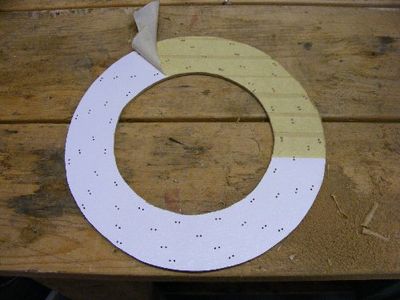

Step 7: Layout of the New Lamp
Tape the nice surface of the white board with masking tape to protect from scratches during all the handling required and to provide a surface to draw on. It also helps keep the cutting and drilling neat.
Remember to measure twice and cut once.
A large circle-drawing compass is most handy in laying out the project. Cut the white board piece to a round circle of a diameter just less than the diameter of the light head, my circle was 8.7 inches (221mm). Band saws work great for this, but a scroll saw will work as well.
Layout and draw the inner circle just larger than the lens; do not cut this out until the holes are drilled. I was able to insert my circle partway and used the open lens hole to trace a draft circle. Then I corrected the trace to make this circle a bit larger. My circle was 5.2 inches (132mm).
Ok, here is the tough part. You need to draw the four equally spaced circles that the LED's will be aligned on, then divide the circles evenly depending on how many LEDs you use. Since I decided to make my light strings 2 sets of 30 LEDs in series with each set of 30 consisting of 2 strings of 15 LEDs in series. I needed to divide each of my 4 circles into 15 equal sections. I found that my circles were too close to fit the jumbo LEDs perpendicular to the circles. I tried to get fancy with a spiral effect. Now go do it.
To make it easy to layout the 2 holes per LED I then used a small circle (same diameter as the LED legs are wide) to speed layout.
Step 8: Holing the Donut
Then use a drill (a drill press is great here) to make 2 holes per LED. Make the holes where each small circle crosses the large circle lines so the LED can be tuned in or out to direct the light to the focal point near the lens.
Now use the large drill bit to make a hole somewhere within the inner circle. Cut out the inner circle to finish "the donut" with a scroll saw. If you are following closely you will notice I cheated the order a bit for the pix.
At this point remove the masking tape, take a moment to admire your handiwork.

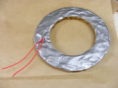

Step 9: LED Wiring
When inserting the LEDs remember the polarity. You can see the polarity when looking carefully in the gel head of the LED. I oriented the holes so that the even circle LEDs are oriented the same polarity and the odd circles are in reversed polarity. Consider the inner circle as even.
I put a small piece of tubing on each leg to raise the LED off the board so it could later be adjusted for focal point alignment. You could also use tiny beads or even small bits of wire insulation too.
Manage to get a good picture of the wiring job so you can get an idea from the pix and from the Dave Johnson strip light, just think round instead of straight. Most of the solder connections can be done using the LED leads (use extra bare wire as required).
Finish the wiring with two wire pigtails as shown. This makes for easier testing and assembly. Use the duct tape to cover the wiring on the back of the donut.
(You may want to jump ahead at this point and test the wiring. Remember; do not just connect 120Vac to the pigtails, as the circuit also requires the capacitor and resistor. Instead temporarily connect to the upper lamp head unit to test.)
Step 10: Assembling the Lamp Head Unit
Crimp-connect the LED lamp assembly pigtail wires to the black and white wires available in the Lamp Head unit.
Here is a great time to test to see if proceeding would be a waste of time. Plug in and turn on to see that the LEDs light. Yehaw! Then unplug again to continue.
Reassemble the lamp head unit but do not install the flimsy plastic light diffuser shell yet. I used the original florescent lamp holding clips modified a bit, see pix, because these clips also hold in the glass lens, so why reinvent the wheel.
I found no need to rebalance the weight of the upper lamp unit to compensate the springs as the final weight was about equal enough to original weight head weight. You may need to add a bit of weight, or not.
