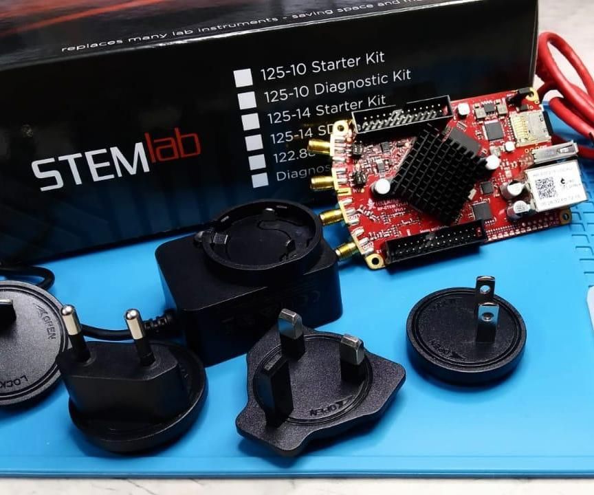

Step 1: Use of Red Pitaya 125-10 in the Application
Red Pitaya Stemlab 125-10 is an effective replacement of big machinery with a wide application in academic, industries, research, and HAM radio fields. One can not only use it as an instrument but also as a versatile development board and powerful tool.
The board involves strong performance such as remote accessibility with a WEB app user interface accessible through Ethernet or Wi-Fi. The mass storage device for the operating system is a micro-SD card.
With some additional accessories like oscilloscope probes, logic analyzer probes, BNC-SMA connectors, wireless dongle, the device is completely ready to have our hands-on.
Red pitaya's function generator and oscilloscope feature made it possible for designing this without any costly instruments. Thanks to team Redpitaya for helping students like me by providing there devices at discounted prices.
