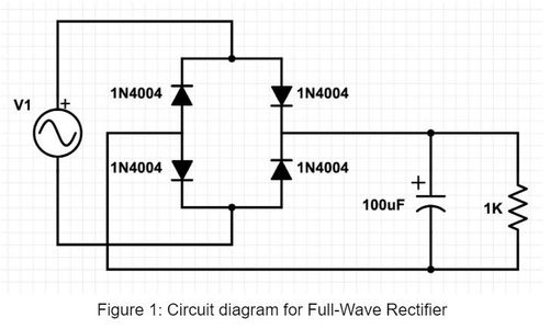

The full-wave rectifier consists of an arrangement of diodes, capacitor, resistor, and an AC voltage source. The input to the circuit is an AC voltage source and its output is a DC signal, the output is not purely DC but with the use of a smoothing capacitor the output voltage can become relatively stable.

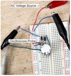

Step 1: Gather all materials required and a breadboard, and ensure there is sufficient wire to connect the nodes in the circuit.
Step 2: Begin by constructing the diode junction on the breadboard. Pay special attention to the direction of the diodes and ensure that your circuit is replicating the same formation.
Step 3: Connect the smoothing capacitor and resistor across their respective nodes that connect the components to the diode junction. Note that the circuit’s ground and the ending node for the capacitor/resistor are not the same. Confusing these nodes will affect the wave output of the circuit.
Step 4: Connect the AC voltage source to the rails of the breadboard. The AC signal that was tested and simulated was a 10 Vpp, 120 Hz sinusoid.
Step 5: Use an oscilloscope probe to view the signal across the resistor. You should see a DC signal at around 3 V.
