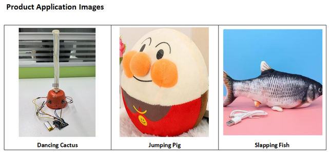

  1. Interactive Toys: Dancing plush toys, talking animals, reaction-based games
  2. Educational Kits: Voice-recordable flashcards, story-telling devices
  3. Home Automation: Sound-activated switches, Bluetooth speakers with effects
  4. Art Installations: Motion-reactive sound and light displays

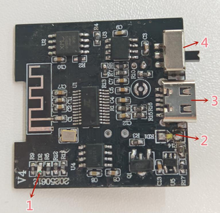

Step 1: Features
  1. Audio Playback: Supports up to 60 MP3 files stored in 4MB flash memory
  2. Bluetooth Connectivity: Stream music from your phone
  3. Voice Recording: Up to 5 minutes of recording with one-button control
  4. Motor Control: Supports both unidirectional and bidirectional motors
  5. LED Control: Connect RGB or single-color LEDs for visual effects
  6. Infrared Sensor Support: Enable remote control or trigger-based actions
  7. Type-C Charging: Modern and convenient power input
  8. Low Power Design: Operates from 3.5V to 5.2V, ideal for battery-powered toys

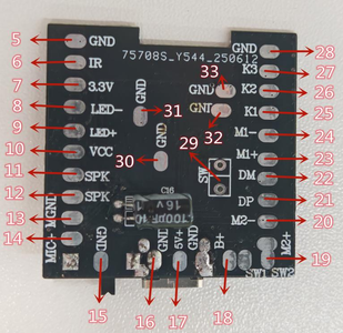

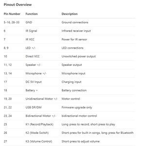

Step 2: Hardware Setup
Wiring Example: Dancing Cactus
  1. Connect a unidirectional motor to pins 19 and 20 for movement
  2. Connect an LED to pins 8 and 9 for lighting
  3. Connect a speaker to pins 11 and 12 for sound
  4. Power the module via Type-C or battery (pin 18)
Step 3: Software & Control
The module does not require programming for basic functions, but you can customize behavior via button combinations:
  1. Voice Change Mode: Default mode on power-on
  2. Recording: Long-press K1 to record, short-press to play back
  3. Bluetooth Mode: Long-press K2 to enter pairing mode
  4. Volume Control: Short-press K3 during playback
For advanced users, the module supports firmware upgrades via USB DP/DM pins.
