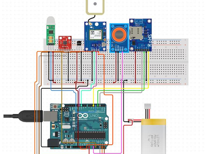

Step 4: HARDWARE PART
The hardware devices to be used for accident prevention, detection and reporting system are eye blink sensor, temperature sensor, alcohol sensor, accelerometer, GPS module, GSM module, buzzers,led, microcontroller (Arduinouno), power supply, connecting wires etc.
EYE BLINK SENSOR
The eye blink sensor senses the eye blink using infrared signal. The variation across the
eye will vary as per the eye blink. If the eye is closed the output is high otherwise the
output is low.
TEMPERATURE SENSOR (LM35)
LM35 is a precession Integrated circuit Temperature sensor, whose output voltage
varies, based on the temperature around it. It is a small and cheap IC which can be used
to measure temperature anywhere between -55°C to 150°C. It can easily be interfaced
with any Microcontroller that has ADC function or any development platform like
Arduino.
ALCOHOL SENSOR (MQ-3)
MQ-3 module is suitable for detecting Alcohol, Benzine, CH4, Hexane, LPG, CO.
Sensitive material of MQ-3 gas sensor is SnO2, which with lower conductivity in clean
air. When the target alcohol gas exists, the sensor’s conductivity is more higher along
with the gas concentration rising. MQ-3 gas sensor has high sensitivity to Alcohol, and
has good resistance to disturb of gasoline, smoke and vapor. This sensor provides an
analog resistive output based on alcohol concentration. When the alcohol gas exists, the
sensor’s conductivity gets higher along with the gas concentration rising.
ACCELEROMETER (ADXL 335 MEMS)
An accelerometer is a device that measures proper acceleration. Proper acceleration,
being the acceleration (or rate of change of velocity) of a body in its own
instantaneous rest frame, is not the same as coordinate acceleration, being the
acceleration in a fixed coordinate system. For example, an accelerometer at rest on the
surface of the Earth will measure an acceleration due to Earth’s gravity, straight
upwards (by definition) of g ≈ 9.81 m/s2. By contrast, accelerometers in free fall (falling
toward the center of the Earth at a rate of about 9.81 m/s2) will measure zero.
GPS Module (SIM 28ML)
A GPS navigation device, GPS receiver, or simply GPS is a device that is capable of
receiving information from GPS satellites and then to calculate the device’s
geographical position. Using suitable software, the device may display the position on
a map, and it may offer directions. The Global Positioning System (GPS) is a global
navigation satellite system (GNSS) made up of a network of a minimum of 24, but
currently 30, satellites placed into orbit by the U.S. Department of Defense.
BUZZER
A buzzer or beeper is an audio signaling device, which may be mechanical,
electromechanical, or piezoelectric. Typical uses of buzzers and beepers include alarm
devices, timers, and confirmation of user input such as a mouse click or keystroke.
D.C. MOTOR (CONTROL SWITCH)
A DC motor is any of a class of rotary electrical machines that converts direct current
electrical energy into mechanical energy. The most common types rely on the forces
produced by magnetic fields. Nearly all types of DC motors have some internal
mechanism, either electromechanical or electronic, to periodically change the direction
of current flow in part of the motor.
MICROCONTROLLER (ARDUINO UNO R3)
The Arduino Uno R3 is a microcontroller board based on a removable, dual-inline-
package. The board is equipped with sets of digital and analog input/output (I/O) pins
that may be interfaced to various expansion boards(shields) and other circuits. The
board has 14 digital I/O pins (six capable of PWM output), 6 analog I/O pins, and is
programmable with the Arduino IDE (Integrated Development Environment), via a
type B USB cable. it has one 5v output pin and one 3.3v output pin. it also contains
three ground pins.

Step 7: SCHEMATIC DIAGRAM
