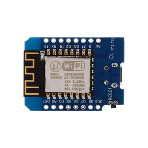

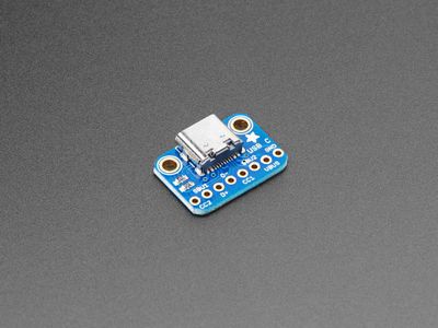

  1. USB Type-C Connection: If you want to connect your D1 mini to your laptop or power source, you can use a USB Type-C Breakout board. This board allows you to connect to downstream devices and provides a stable power supply to your D1 mini.

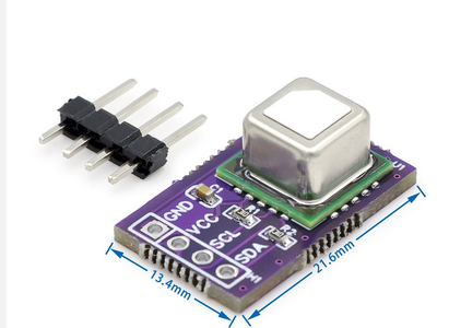

  • SCD40 Sensor : The SCD40 Sensor is the main component of this product, responsible for measuring temperature, humidity, and CO2 levels. The board includes a temperature and humidity sensor, as well as a CO2 sensor. These sensors measure the respective values and send the data to the microcontroller. to connect this part you need to find the SDA (D2) and SCL (D1) pins in the D1 Mini .
  • Microcontroller: The microcontroller is responsible for receiving data from the sensor board and processing it. It is the brain of the system, using the data to determine the correct output for the LEDs. The microcontroller sends this output to the LED driver.

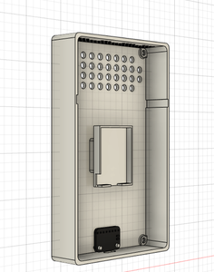

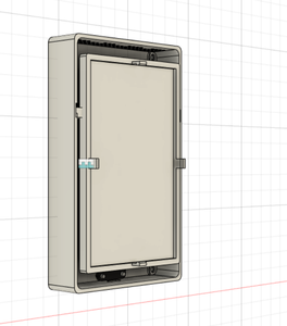

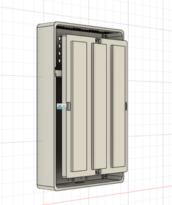

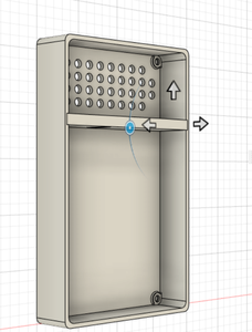

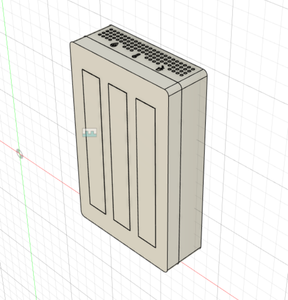

Step 3: 3D Modeling on Fusion360
