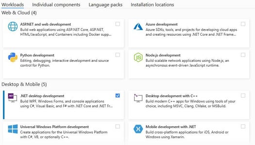

For this project, Visual Studio is being used. Mind you, this is the full environment, and not the Visual Studio Code environment. Get your copy at the Microsoft site (the free community edition will do).
This is a hefty install, taking up several gigabytes on your hard disk. You don't need to install all the available options. For the purpose of this tutorial, you will only need the .Net Desktop environment.

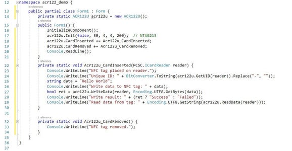

We'll take the first line of code private static ACR122U acr122u = new ACR122U( );and paste it at the right place in our code. You can see it at line 13 in the picture above. You'll notice some red waves under the words ACR122U, indicating an error. This can quickly be solved by right clicking on the word, then selecting Quick actions and refactoring and then selecting Using SydeSoft.NfcDevice;
Now your error should have disappeared.

Based on the code from SydeSoft, we make adjustments to our code.
The first 3 lines of code that originally were in the code of Main (typical for a console application) are put within the constructor of the Form1.
The rest of the code is copied below that, as shown in the picture.
Having done this, you can test drive your application. Nothing will be shown in the window yet, but you can see the result of your actions in the console of the development environment. Use the CTRL+ALT+O or view->output menu to see the console. Depending on the type of tag you are using, you may get an error while writing, if your tag is readonly.

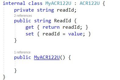

We change the line of code where the object acr122u is created. In our original code, it is an object created on the class ACR122U (be aware of the casing). We will make our own class, derived from this class, in which we will add a property in which we will store the data. For purposes of demonstration, the ID will be used.
The modifications to be made, are:
- Change the definition of the acr122u variable to private static MyACR122U acr122u = new MyACR122U();
- Right click on the word MyACR122U and select Quick actions and refactorings, then Generate class 'MyACR122U'
- Scroll to the bottom of the source code and modify the code as in the picture above

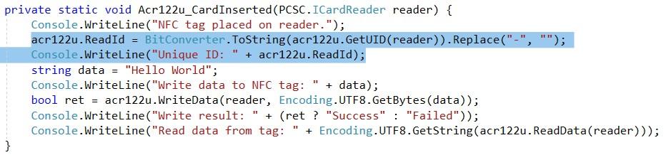

- Do some extra work on the code in the Acr122u_CardInserted method
