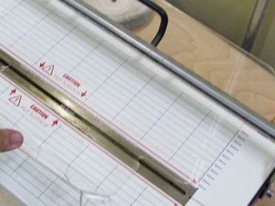

Step 3: BEND THE FLAT USING THE HEAT STRIP BENDER
Turn on the heat strip bender, set it to maximum temperature and let it warm up for ten minutes or so. You are going to make a series of four bends. The flat is etched with the bends marked in the sequence you should do them.
Bend #1
Place the first bend (marked "Bend #1") on the heat strip bender as shown in the first image. Wait a minute or two for the acrylic to soften, then make a 90 degree bend as shown in the second image. Hold the acrylic sheet in place while it cools.
Bend #2
Repeat the process above on the other side for the second bend.
Bend #3
Place the third bend on the heat strip bender as shown in the third image, above. Once the acrylic has had time to soften bend it on a flat surface as shown in the fourth image. Allow the acrylic to cool completely before proceeding.
Bend #4
Set the angle bender to 63 degrees. Place the final bend ("Bend #4) on the heat strip bender as shown in the fifth image above. Once it has warmed up, bend it on the angle bender as shown. Hold the piece firmly in position while it cools (and hardens).
