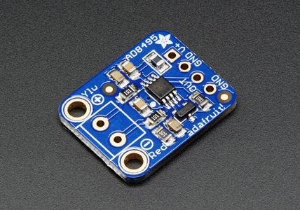

Introduction: AD8495 Breakout Board Solution
Hey there! I purchased a bunch of AD8495 breakout boards to record (5) type-K thermocouples. These were the perfect match for my range of temp and application - or so I thought...My readings were fluctuating and inaccurate (51% error!).
After running some calibration tests, lots of swearing, crying, and acceptance of my doom (i kid!)- I found a solution to get precise and accurate readings from the AD8495 breakout board (ADBB). My colleagues and I worked on this together, so they deserve some credit too!

EDIT: In my first version, I used (and recommended) a 20M Ohm resistor which is contrary to what is advised in the AD8495 datasheet. I have not tested it with a 50kOhm resistor, but this is the recommended resistor value for your LPF.
My readings were fluctuating up to +/- 10 degrees. In order to make the ADBB precise, a simple low pass filter will make a world of difference.
Do this by placing a .1uF capacitor and a 50kOhm** resistor in your circuit (see photo). If you have a 1uF capacitor, that will work too.
That is it for precision. The addition of the RC low pass filter should clean up your signal A LOT.

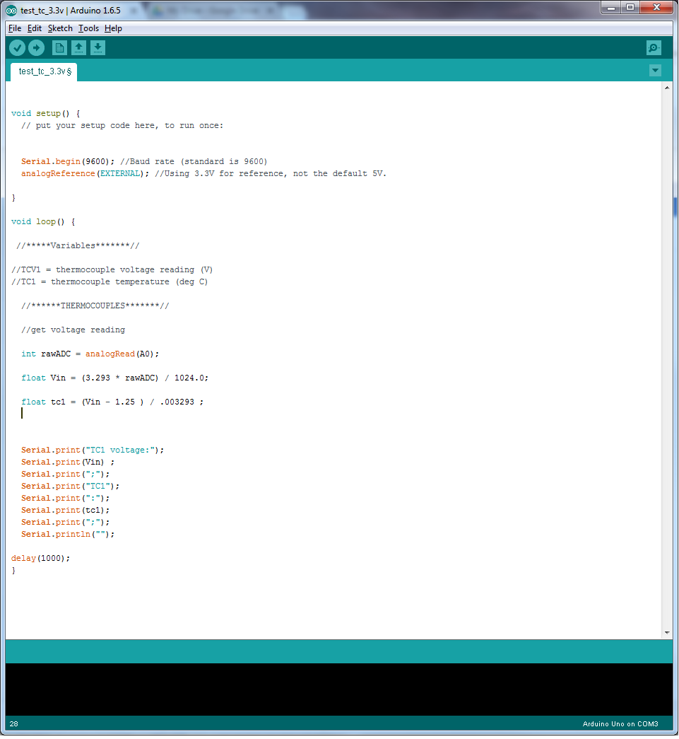

Step 3: Software
With the new equation, you will need to edit your Arduino code (or whatever you're using). I've included screen shots of before and after. Also, I've included my new tests results with the new equation.
Step 4: Conclusion
I tested the equation by plugging in 1.71 V and my output was 94.2 deg C. That is .86% error from 95 deg C! Much improvement from 51% error that I was receiving before.
