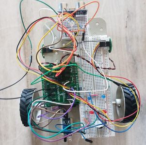

This robot uses a combination of sensors and output devices to simulate features of an Advanced Driver Assistance System (ADAS). It includes four sensors:
  1. Ultrasonic Sensor (HC-SR04) to detect and avoid obstacles in front.
  2. Infrared Sensor (REES252) at the rear to detect motion or proximity for applications like parking and rear-collision alerts.
  3. Two Light Dependent Resistors (LDRs) to monitor ambient light and adjust lighting accordingly.
An Arduino Uno with a motor shield controls the robot's functions. The robot’s body is built on a steel chassis, powered by two DC motors, and includes output devices like LEDs and a buzzer for feedback. Breadboards and resistors are used for circuit assembly and voltage regulation. Overall, the robot demonstrates basic ADAS functionality, enhancing environmental awareness and adaptive responses.

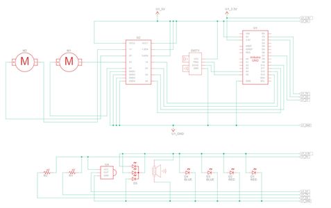

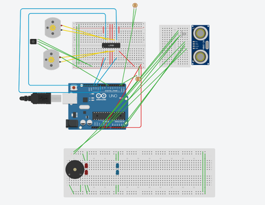

Step 5: Circuit Diagram
The above circuit is designed using TinkerCad software
