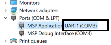

After running the code in CCS, to create the terminal connection (Putty or the CCS built in terminal) you should use the COM port indicated in the device manager (for Windows) and you should set the baudrate to 19200 (this is set in the C code)
In the terminal window, you'll see the ADCMEM register value (between 0 and 1023) and the corresponding Voltage level in the second line. You can compare these values if you use a multimeter for the Potentiometer Output.
