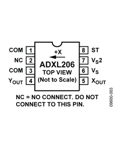

Step 2: Wiring
The first thing to look at when you have a new part is the datasheet. If you look at the pinout, you will see COM (basically ground), v1 (+5V), XOUT, and YOUT. Connect the following:
Pin 1 (COM) to GND
Pin 3 (COM) to GND
Pin 4 (YOUT) to A1
Pin 5 (XOUT) to A0
Pin 6 (Vs) to 5V
Pin 7 (Vs2) to 5V
Note : Do not connect pin 2 to anything or else this will not work.
