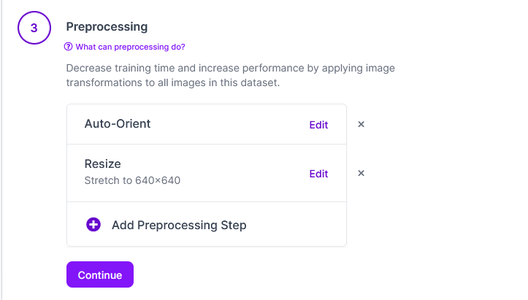

To enhance the quality and diversity of my dataset, I leveraged Roboflow's powerful preprocessing and augmentation tools. These steps were crucial in improving the performance and robustness of my AI models for face recognition and classification.
Preprocessing includes options like , Resizing, Normalization, Grayscale Conversion. These tools directly changes you original images.

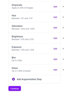

Augmentation: This tool will create more images based on your original dataset. here, we have a wide range of options like Grayscale, brightness and etc.
By applying these preprocessing and augmentation techniques in Roboflow, I was able to create a robust and diverse dataset. This comprehensive approach significantly improved the training process and performance of my AI models, making them more effective in real-world scenarios.

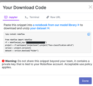

So, after my dataset was ready I could export my dataset as I have shown it in the image i have provided. the we can use the code we have recieved to download our dataset.

Dataset Download from Roboflow
  1. Generating the Download Code: In Roboflow, I utilized the platform’s feature to generate a code snippet for downloading the annotated and augmented dataset. This code snippet ensures that I have the latest and most optimized version of the dataset for training my models.
  2. Downloading the Dataset: By running the provided code snippet in my development environment, I downloaded the dataset, which was preprocessed and augmented, ensuring high-quality input for model training.

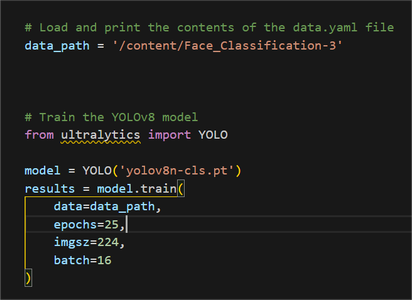

Training the Models
Using the downloaded dataset, I proceeded to train the face detection and classification models with the code snippets provided by Roboflow. These snippets were tailored for efficient and effective model training.

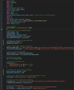

AI Client (Laptop)
Purpose:
  • The primary function of this code is to run AI models for face detection and classification using the YOLO framework.
  • It captures the video feed from a USB camera, processes each frame to detect and classify faces, and determines if the detected face is authorized or unauthorized.
  • Depending on the classification result, it sends corresponding commands to the Raspberry Pi server to either unlock the door or send an alert.
NOTE: For alert I used trial SMS service by twilio.

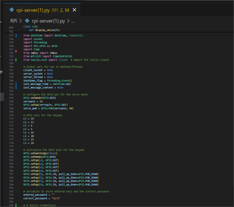

Raspberry Pi Server
Purpose:
  • This code serves as the server that receives commands from the AI client (laptop) and performs hardware actions based on these commands.
  • It controls hardware components such as a servo motor (to unlock the door), an LCD display (to show messages), and an RFID reader (for additional access control).
  • Additionally, it monitors keypad input for manual password entry and sends SMS alerts for unauthorized access using Twilio.
