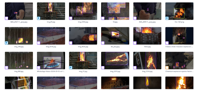

Step 1: Dataset
I collected a dataset from different sources like internet, keggle, and some of my own pictures. I used Roboflow for labeling as it has user friendly and relatively easy to use UI.
This is my dataset that I used:DATASET
Step 2: Collect and Label
We need to find different data such as with campfires, houses under fire, wildfires. I strongly recommend you to find as much data as you can, because you are trying to identify such a hard data like smoke that is pretty had to identify, and suggest to use greyscale on your dataset to help your model to under where the smoke is.

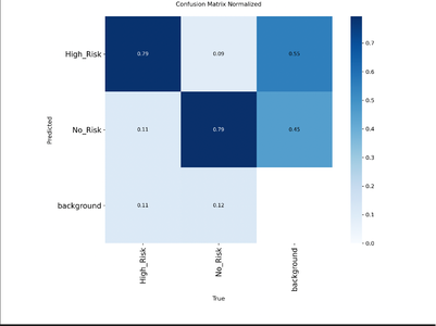

Step 3: Training YOLO Model
At first try to run model on roboflow website to check if you have enough data, if its fine you can try to run a script to run your model on vscode here is the code:

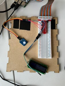

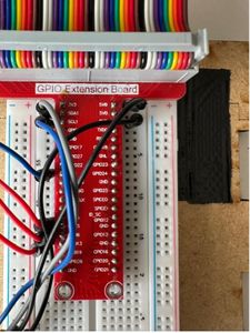

Step 5: Electronic Part
Here are all assembled modules

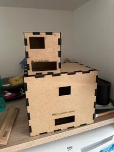

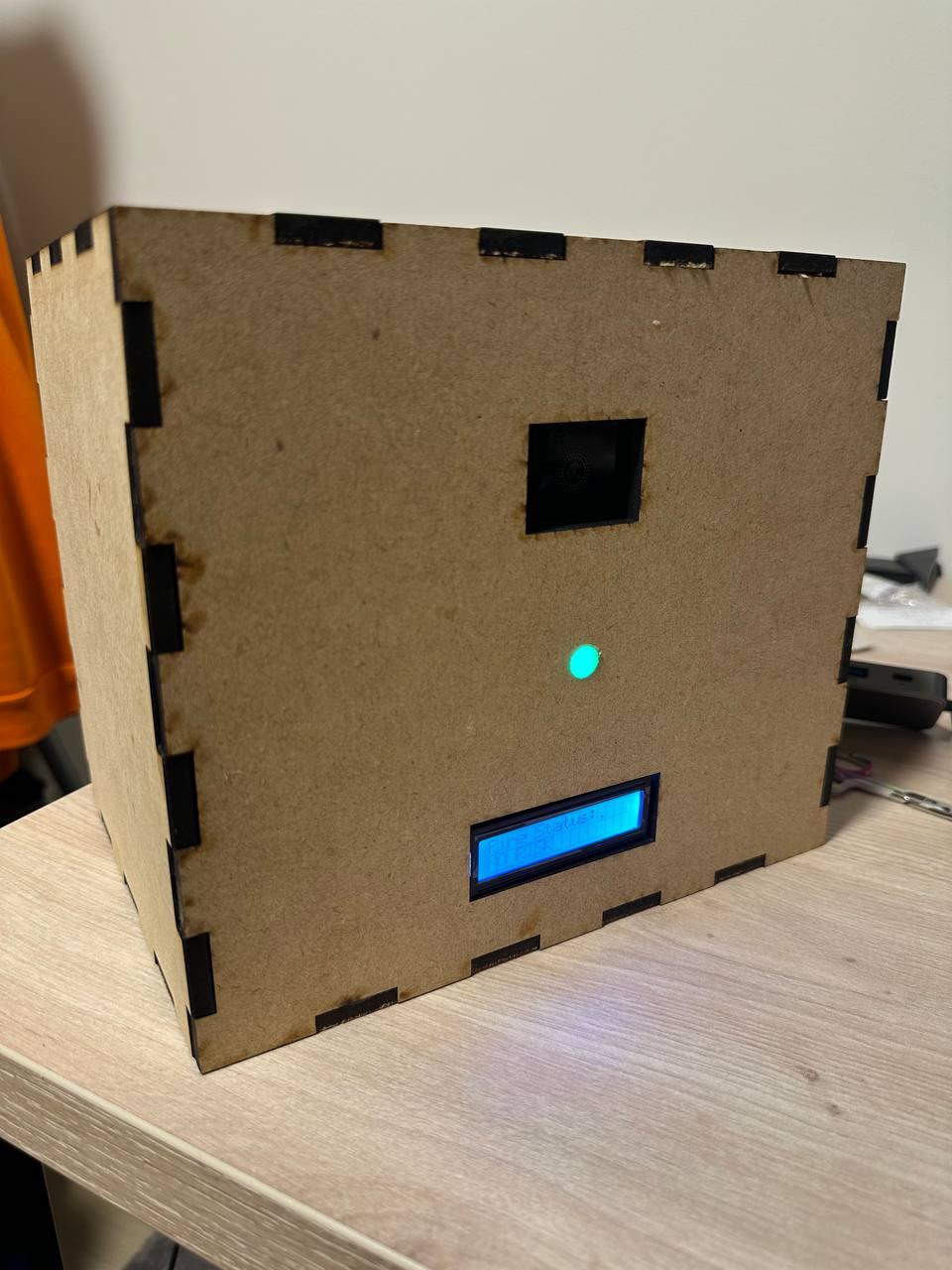

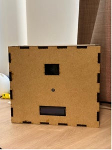

Step 6: Building the Box
For casting I used MFD 6mm but can be such less complicated like simple wood.
