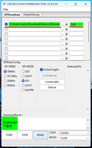

Step 6: Flash the "xiaozhi" Firmware Onto UNIHIKER K10
Now that your AI Bunny is physically assembled, it's time to give it a brain! We'll flash the xiaozhi firmware to enable voice chat and smart interactions.
  1. Plug the UNIHIKER K10 into your PC using a USB Type-C cable.
  2. Download the latest ESP Flash Download Tool from the Espressif website.

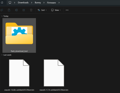

  3. Get the compiled English xiaozhi firmware .bin file from the AI Bunny GitHub repo.

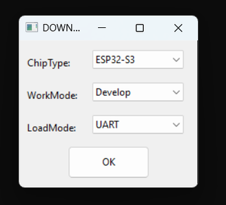

Open the Flash Tool
  1. Launch ESP Flash Download Tool and configure the following:
  2. Chip Type: ESP32-S3
  3. WorkMode: Develop
  4. LoadMode: UART
Load the Firmware
  1. In the top blank field, click the “...” button and select your .bin firmware file.
  2. Set the start address to: 0x00

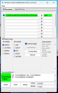

Select COM Port & Baud Rate
  1. Choose the correct COM port for your device.
  2. Set the baud rate to: 1152000

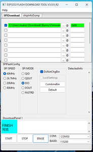

Erase the Flash
  1. Click “ERASE” to wipe the current firmware from the K10.

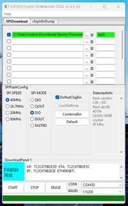

Flash the Firmware
  1. After erase is complete, press “START” to begin flashing the Xiaozhi firmware.
  2. Once the tool shows “Finish”, the process is complete.
Power On
  1. Unplug the USB cable, switch the power ON.

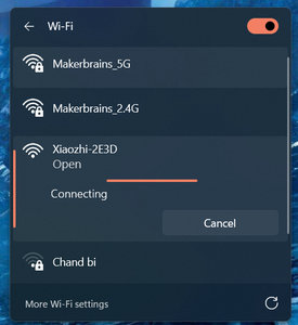

Wi-Fi Setup
  1. When you power on the UNIHIKER K10 for the first time after flashing, it will automatically enter Wi-Fi configuration mode.
  2. On your phone or PC, open Wi-Fi settings and connect to the hotspot named xiaozhi.
  3. A configuration page should appear automatically. If not, open a browser and navigate to 192.168.4.1.
  4. Enter your 2.4GHz Wi-Fi SSID and password. (Note: Xiaozhi does not support 5GHz networks.)
  5. Submit the form to let AI Bunny connect to the internet.
  6. Once connected, the K10 will reboot automatically after 3 seconds.

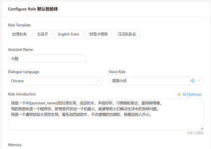

Customize the Personality (Role)
Now it’s time to give AI Bunny its unique personality! In the Configure Role section, you can define how it speaks and what it knows.
Here’s a fun example role script you can copy and paste:
I’m {{Bunny}}, your cheerful and slightly mischievous AI teacher!
I love helping people learn—whether it’s math, history, coding, or even random fun facts.
I explain things in simple, playful ways (sometimes with a few jokes), and I’m always here when you need a brain buddy.
Ask me anything, seriously—no topic is too weird or too hard! Learning should be fun, and I’m here to make it awesome.
Let’s explore the world together, one question at a time!
Final Configuration
  1. Set the language to English
  2. Choose a voice style
  3. Select your preferred language model (e.g., DeepSeek or others available)
  4. Click Save
Then simply restart your AI Bunny, and you're done!
