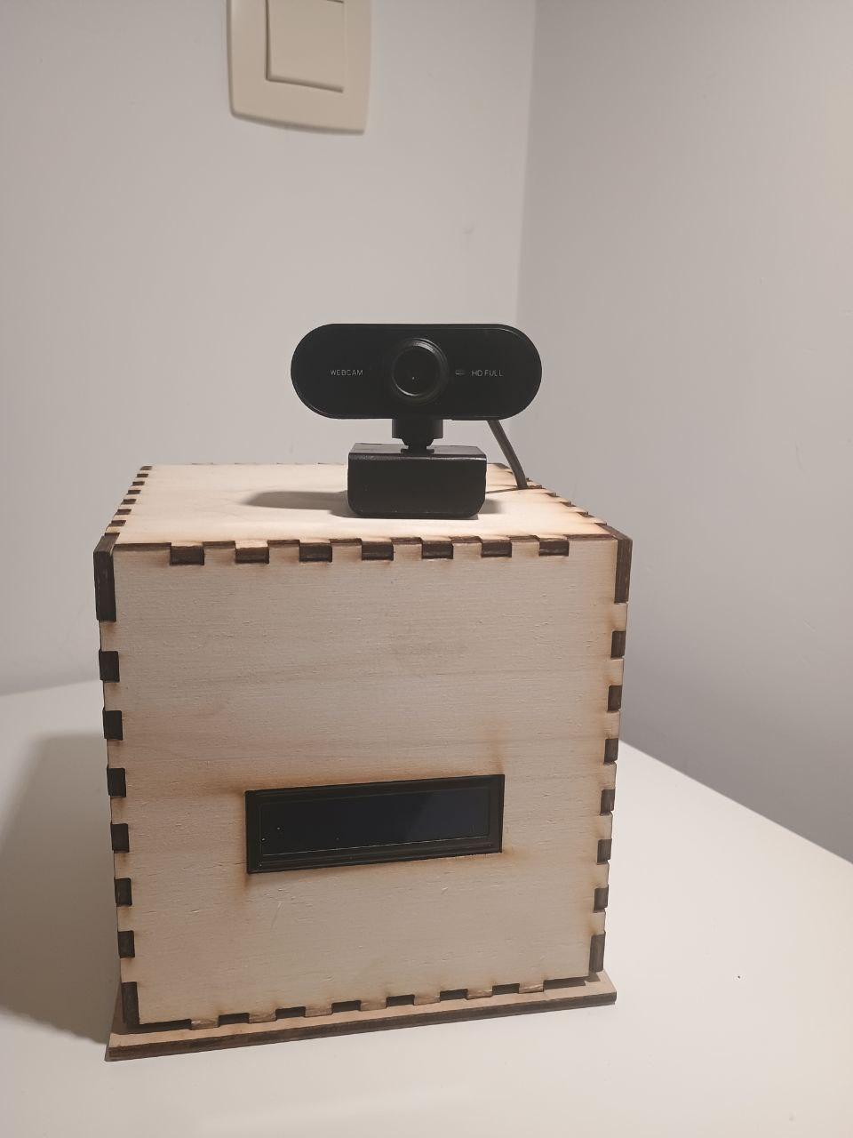

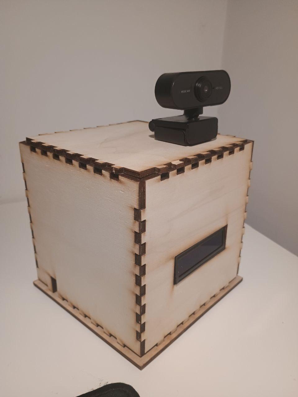

A 16 × 2 I²C LCD on the Pi shows what’s playing in real time, so anyone in the room can see why the music changed. The whole unit is housed in a small wooden box I call a “radio” case, with space for the Pi, camera, and—potentially—speakers.

  7. Small wooden “radio” box (DIY / laser-cut) – enclosure for Pi, webcam, LCD. ≈ €10

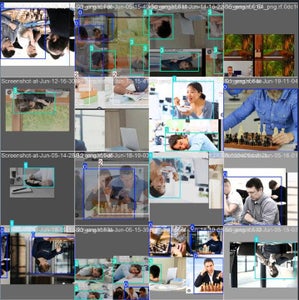

First things first: the project needed a reliable action-detection model, and that meant training my own. I chose YOLO, but of course YOLO is only as good as the data you feed it. My target was a compact dataset—at least 500 images—showing real people performing my five key activities.
I began by scouring Kaggle for public datasets. Plenty looked interesting at first glance, yet most either lacked the exact actions I needed or were shot in artificial studio settings that wouldn’t match a dorm room webcam. So I cherry-picked only the images that fit my scene and moved on.
Next stop was Google Images. Using Creative-Commons filters, I pulled down dozens of candid photos that were both royalty-free and privacy-safe. Still short on a few classes, I turned the camera on my own environment: I corralled classmates, handed out snacks, and snapped them reading, typing on laptops and generally acting natural. The mix of web finds and home-grown shots gave me a balanced, realistic pool of images.
With the pictures collected, the final (and most tedious) task was manual labelling. Every photo went through Roboflow, where I drew a bounding box around the whole scene—person plus the relevant object—and assigned the correct label. Only after that marathon click-fest did I finally have a clean, custom dataset ready for training.
Step 2: Annotating the Data
With a folder full of raw images, I rolled up my sleeves for the click-fest that makes the magic possible: annotation. Rather than wrangle COCO JSON or Pascal-VOC XML by hand, I opened Roboflow, dragged every picture into the browser, and let the workflow guide me.
One box, one label.
For each image I drew a single, generous bounding box that framed the whole scene—both the person and the key prop that tells the story: a paperback for reading, a glowing laptop for working, a steaming bowl of noodles for eating, a chessboard for playing chess, or a blanket-cocoon for sleeping. This “big-context” box gives YOLO enough visual clues without drowning it in tiny, hard-to-learn parts.
Automatic splits.
With the last box drawn, Roboflow handled the dull bits for me: shuffling images into train/validation/test folders and renaming everything to YOLO-friendly format. One export click later and I had neatly paired /images and /labelsdirectories, perfectly organised for the next stage.
Painful on the wrist? A little. Worth it? Absolutely—because clean labels are the difference between a model that just “sort of” works and one that nails the vibe every single time.

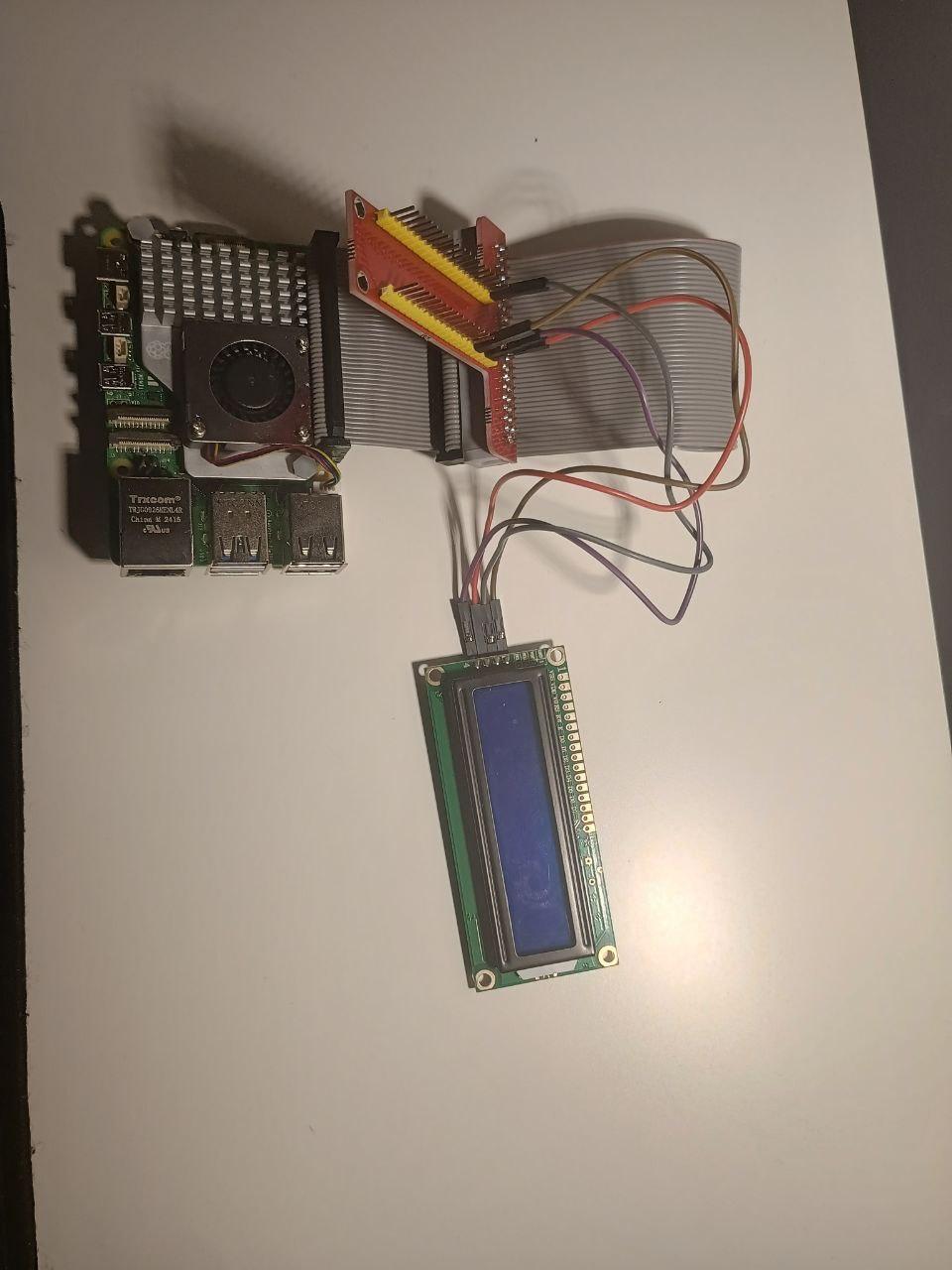

For an extra flourish I decided to bolt a tiny 16 × 2 I²C LCD onto the Raspberry Pi so the AI DJ could literally announce each vibe change as it happened. The wiring was kindergarten-simple—just four jumper leads from 5 V, GND, SDA and SCL—but the effect is pure sci-fi: the moment the camera sees reading, the screen flashes “Activity: Reading” and lo-fi beats seep from the speakers; flick open a laptop and a heartbeat later it proclaims “Working” while synthwave takes over; leave the room long enough and the fallback “Nature mode” scrolls across the display as rain ambience fades in. Under the hood a pocket-sized helper class (a semester-two relic I wrote for our Sensors & Interfacing course) wraps the RPLCD library and hides the I²C gymnastics—one call to lcd_show() is all it takes. The Pi was already POSTing JSON labels to my Mac, so I simply print the same label locally whenever it changes; no need for extra sockets or MQTT detours. It’s a fifteen-line addition to the client script, but it transforms the box from a mysterious mood-shifting appliance into a jukebox that politely tells the whole room why the soundtrack just flipped.
