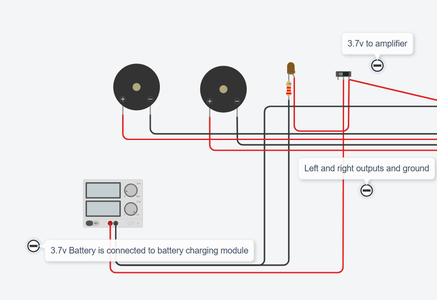

Step 1: Making the Circuit
(Connect 3.7v to the Amplifier board) Do not charge the battery through the amplifier board, charge it through the battery recharging module.

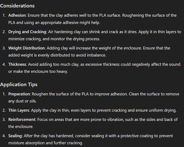

Step 2: Fill Speaker Casing With Air Dry Clay
I asked ChatGPT if Air Dry Clay is good for making the speaker sturdy, and with its output, I filled the speaker with it.

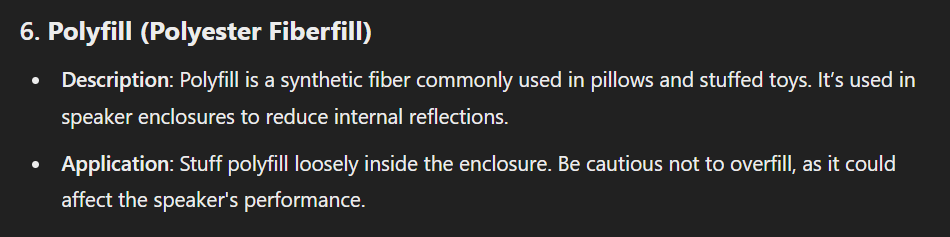

Step 3: Adding Polyfill
Then, I asked ChatGPT on materials absorbing vibrations and it recommended me Polyfill. I had some so I filled the speaker with it.

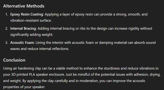

Step 4: Sealing the Speaker
Now I can seal it. I used resin and some superglue to make a tight seal.
